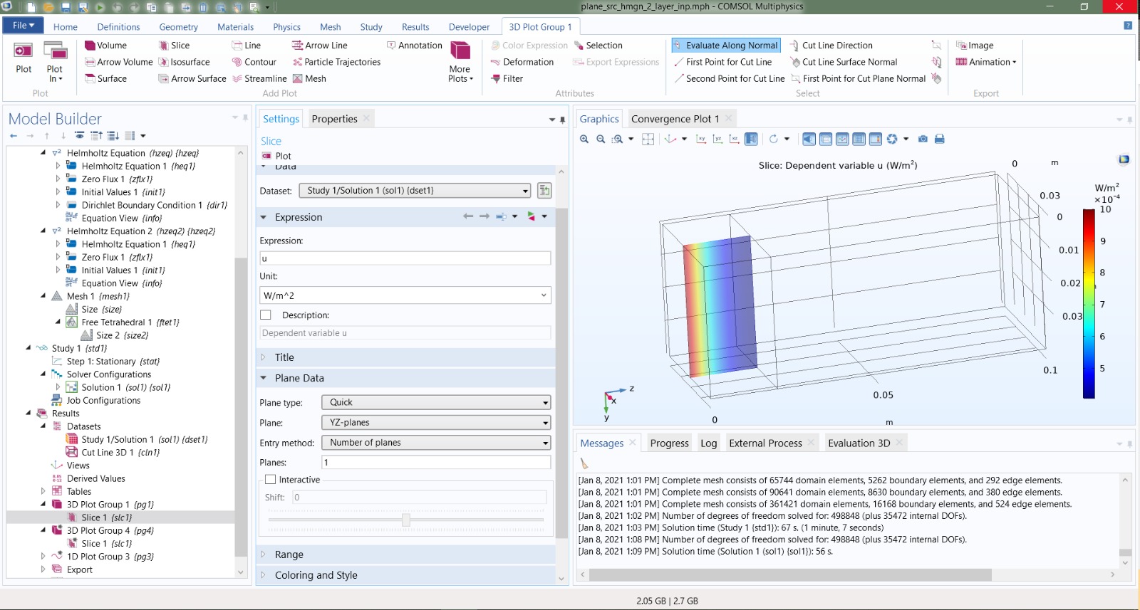

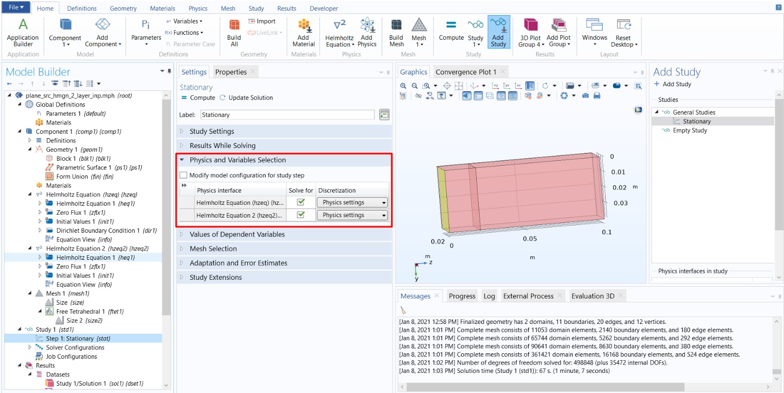

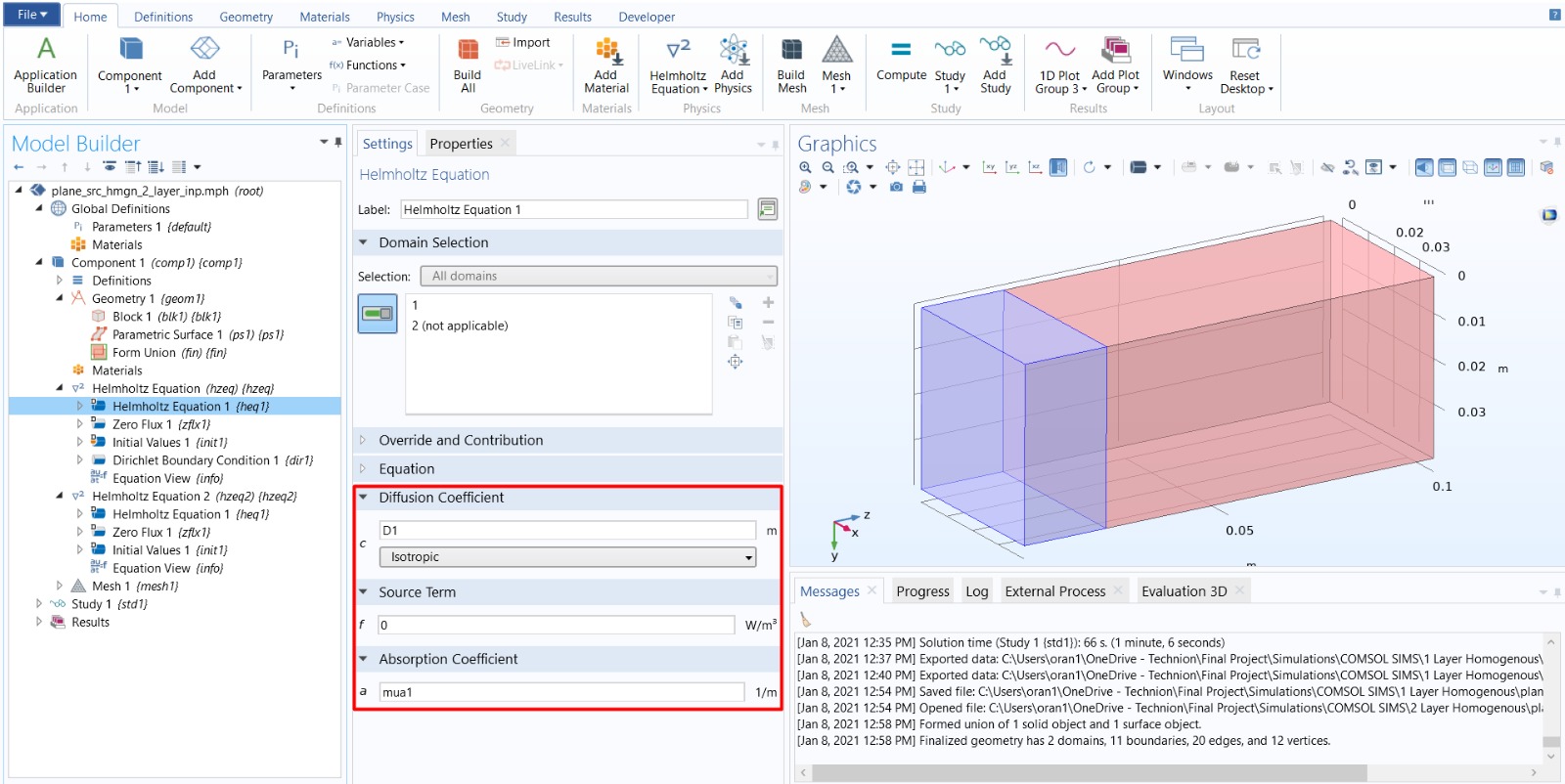

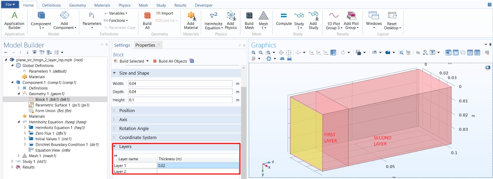

Hello all, I'm trying to simulate Light-Tissue Interaction by solving the RTE in the Diffusion Approx. The stationary form it takes is similar to the Helmholtz Equation. I've managed to get excellent results for a homogenous 3D block with isotropic optical properties. Now I'm trying to simulate 2 layers of material with different (still isotropic) optical properties. The solution propegates nicely in the first layer, but isn't going throguh to the second layer. My method: Setting up a 3D block with 2 layer Setting the Helmholtz Eq. for each layer with different coefficients. As can bee seen in the photos attached, the fluence doesn't go to the second domain.

The issue was I had to define Dirichlet BC as a Continuity condition at the domains interface. Without it the second equatuin didn't have any values to calculate.

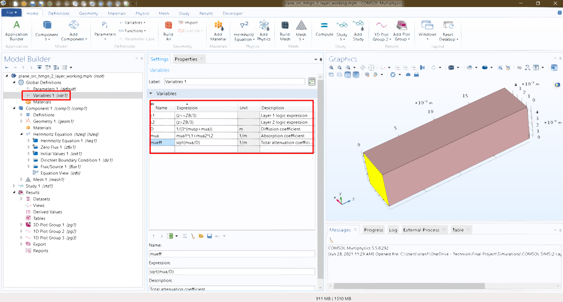

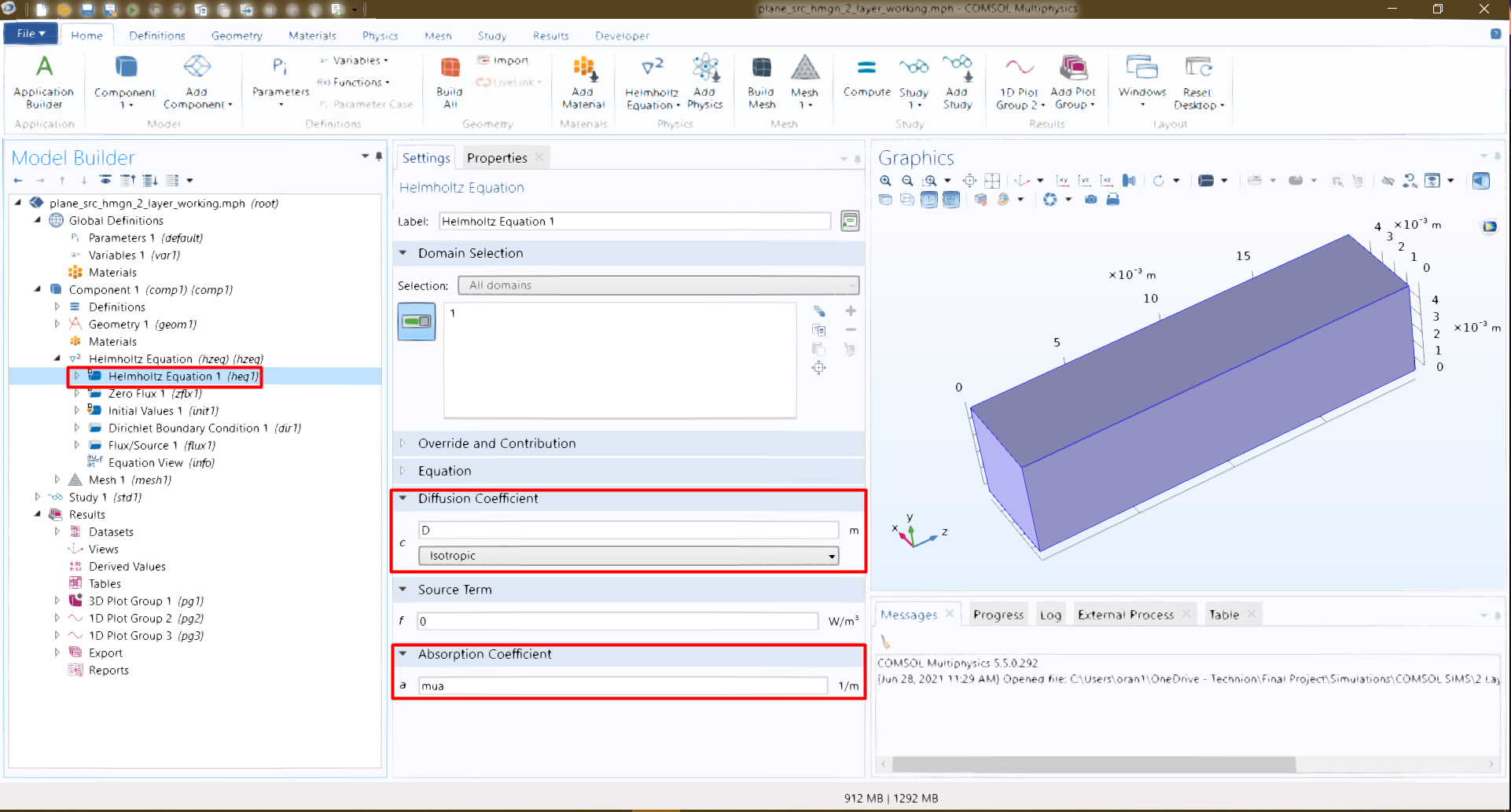

Hi Chaki,
There's 2 options to solve this issue:
1) Define 2 Helmholtz equations within the same component. assuming your variable us , then in the second equation u define Dirichlet BC with prescribed value of . what happens is that it will take the value obatined from the first equation and apply it as continuity. unfortunately I did not use this method so I don't have pictures for you. 2) Using only 1 Helmholtz equation, you can define its parameters as variables. What I did is to define and as a step function that varies in the theoretical boundary, without actualy define a geometric doundary. that solver will handle it.
