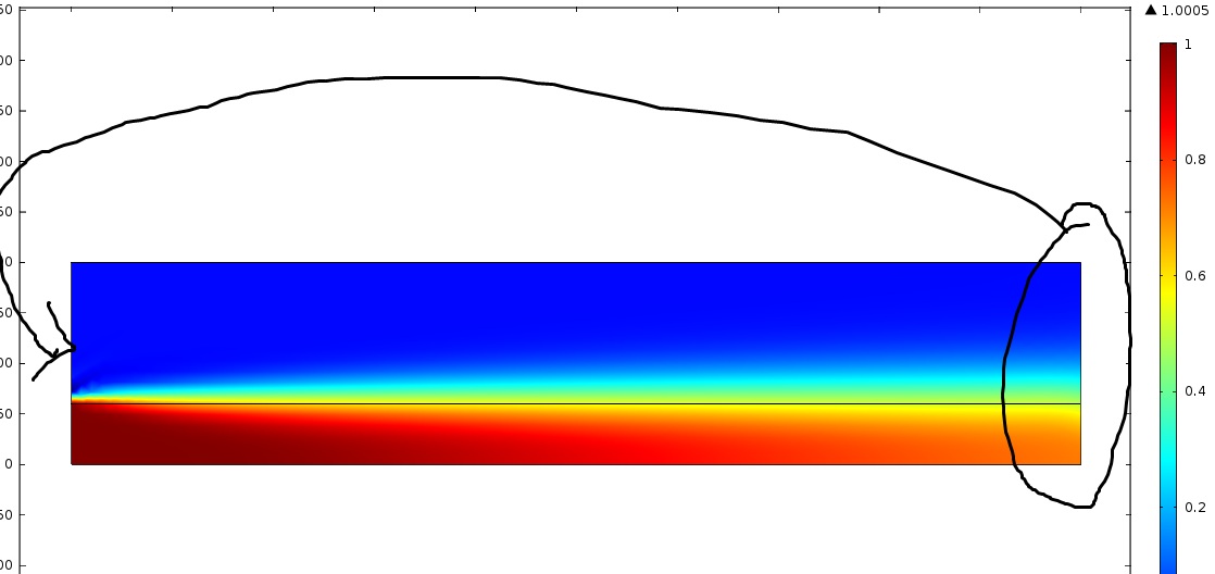

how do I take the concentration profile at the outlet from the first transport of dilute species (variable c) and use it as the inlet boundary condition for my second transport of dilute species (variable c2)?

I believe that is what I did, but I would still get the same concentration profile across the length of the channel for both studies.
Does it have anything to do with the inlet concentration? I am setting the inflow of a boundary to a number (i.e. 1 mol/m^3). Should this be a variable? It seems to me when I run the second study using the previous solution, the inflow boundary would still initialize with 1 mol/m^3 as opposed to the concentration at the outflow boundary from the previous study.

attached is the model I am trying to get it to work in. It would solve, but I have the same solutions for all my stationary steps, even though I set the dependent variables to use the previous solutions.
