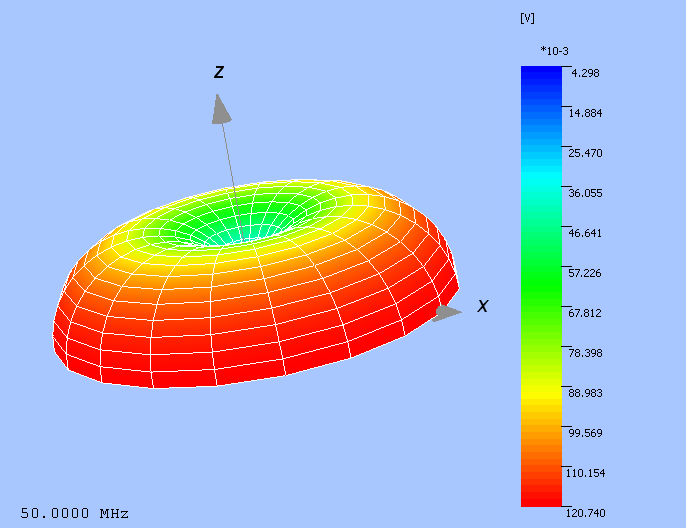

And about the 3D plot. I tried to recalculate results from a other simulation program, see attached picture. I want to compare the simulation of the both programs. And actually it should be same.
