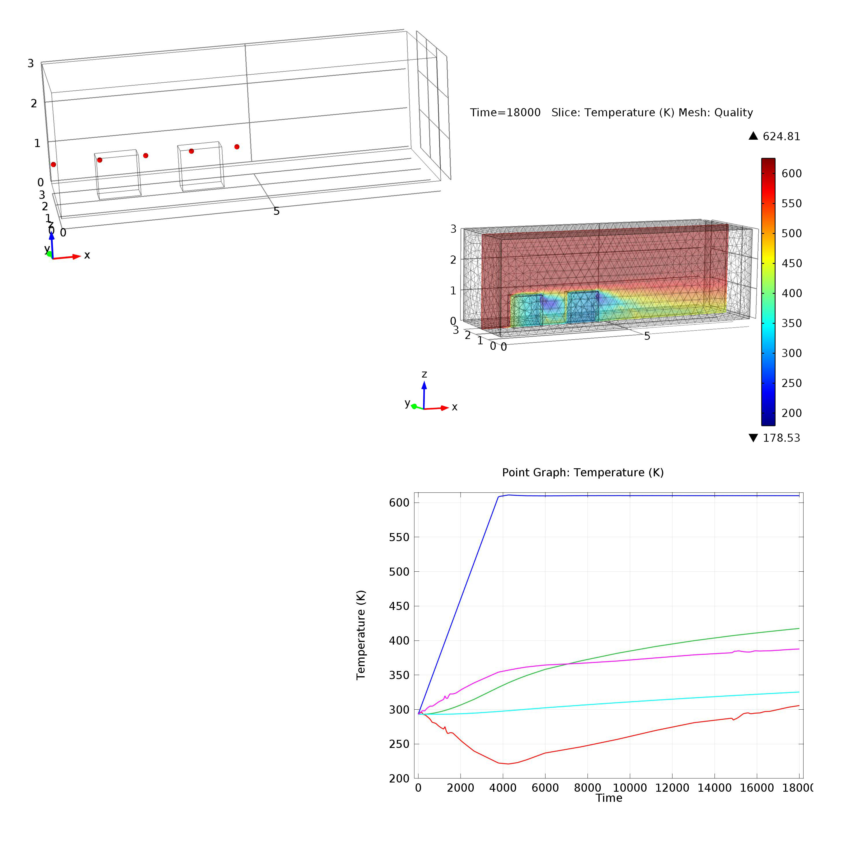

Hi there,
I've made a model for an autoclave with 2 blocks in it that should heat up during time. They however first cool down to like 200K and after they start to heat up again. That's not what i suspect and what is realistic. Since the model with results is to big i will upload only the model. It isnt that big so should be computable in short time;). (comsol 4.2a)
See the attachted image.
hope all is clear.
Thanks in advance!

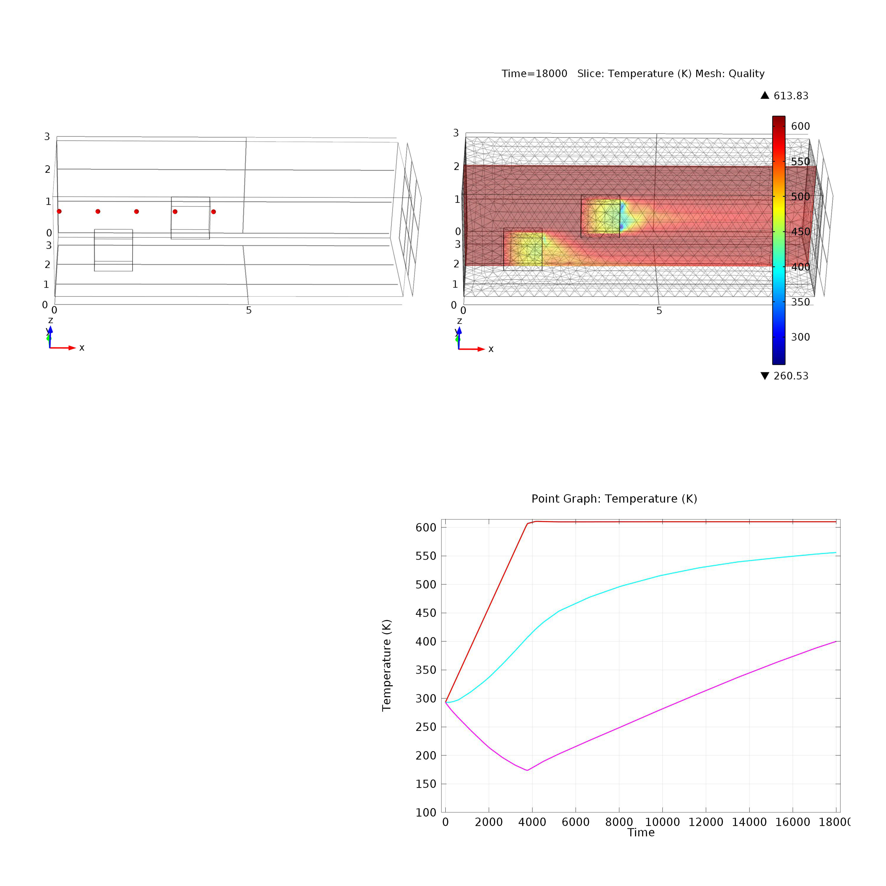

Dear Ivar,
I've added the outflow condition but is still gives me the unexpected decrease in temperature.. The previous results were deleted. I also Included a results graph and empty model.
I also tried to combine the HT an TF but gave me some errors, Will try that later on once again.
What is going wrong?
Dear Ivar, I've added the outflow condition but is still gives me the unexpected decrease in temperature.. The previous results were deleted. I also Included a results graph and empty model. I also tried to combine the HT an TF but gave me some errors, Will try that later on once again. What is going wrong? Thanks

Dear Ivan,
I tried both but i now gives me some strange errors.
What is going wrong, i somehow cannot find the error
thanks
Dear Ivan, I tried both but i now gives me some strange errors. What is going wrong, i somehow cannot find the error thanks
