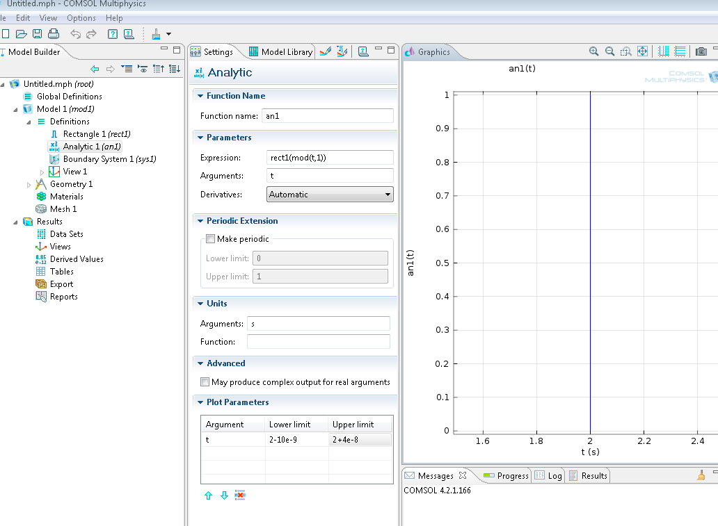

indeed its difficlt to see exactly what is pahhening, as the self scaling of the plots play you a game here

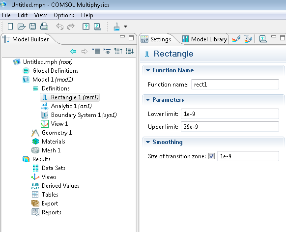

you can aleways combine a rect with a mod(t[1/s],1) see images
Do not forget to carefully define the time sequence and use strict and not free time stepping
I suspect the ration 1e-9 to 1 is too large for the analytical function, try asking "support"
