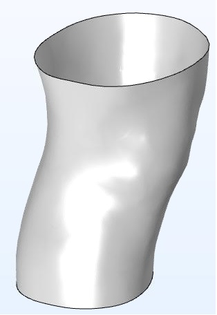

Hello Everyone, I need a help regarding the extrude operation of an imported geometry. Please see the attached image which is a boundary/surface I've extrated from a solid object. Now I would like to extrude the surface by 0.2mm and make a solid object. I've tried with extrude function in 5.6 version, but as I can't select the surface as a face, the operation doesn't work. Can anyone please help me to do this by thinkening the surface by 0.2mm (from an imported geometry).

Are you trying to turn this surface into a pipe with a wall that has a thickness of 0.2mm?
If so, in COMSOL lingo it is not an extrusion, but rather a "thickening" operation. Look for "Thicken" in the GUI. Please note that this functionality is part of the optional Design Module. You can check whether your license includes that product through the File > Licensed and Used Products menu. If your license does not include that product, please contact your COMSOL representative. If you do have the Design Module, then Thicken will be one of the Conversions available in the dropdown menu that appear when you right-click on the Geometry node in the Model Builder.

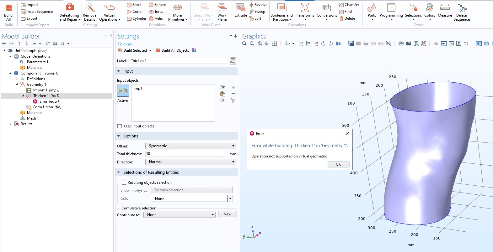

Hi Jeff, Thanks, I'm pleased to have your reply. Yes, I'm trying this surface into a pipe with a wall thicknes of 0.2mm and I attepted for "Thicken" operation but received the error message - 'Operation not supported on virtual geometry'. As I said, this is an imported geometry, lets say a stl file but I've converted this to a geometry as a surface. You may ask, why I'm not using COMSOL genetrated circular pipe but the answer is, I need to use the organic shaped object with wall thickness of 0.2-10mm. Could you please help me with the solution for that?
Many thanks. Chironjeet
