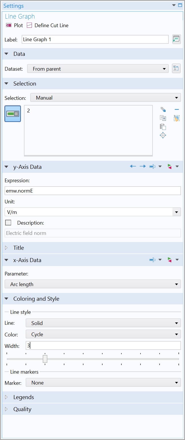

A Line Graphe has been generated in Comsol, and I want to copy it to MS.word.
On the "Image Snapshot" window, I can modify the font size, color theme, etc.
But the line is too slim.
How to modify the line width?

For the plot in question, go to Settings, and Coloring and Style. Under Line style, change the Width value to a number larger than 1. See the attached figure.

It works. Thank you so~ much.
