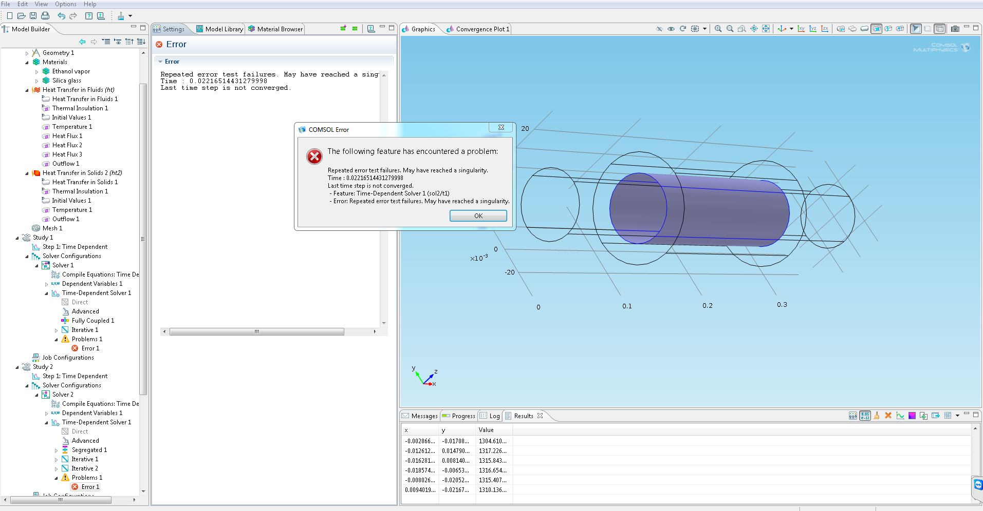

Again I come over to you for this problem i don't understand...time step error.
Please need your help

do NOT add a second physics HT2, but add a "Domain Heat Transfer in Solid" physics node in the first HT
Than will make your life far easier ;)
