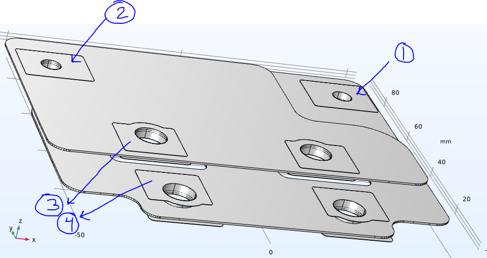

Is it possible to connect two surfaces/boundaries virtually in COMSOL? I am studying joule heating as well as magnetic analysis of copper bars, and drawing interconnection wires/geometry for electrical connection is appearing to be difficult with the component under consideration. Is there a way I can choose two surfaces/boundaries and speciy that there is a zero electrical voltage difference in these? This in essence would provide a continous path of current in between two selected surfaces.
As an example, I am trying to connect (3) and (4) which are electrically isolated. Refer to the attachment.

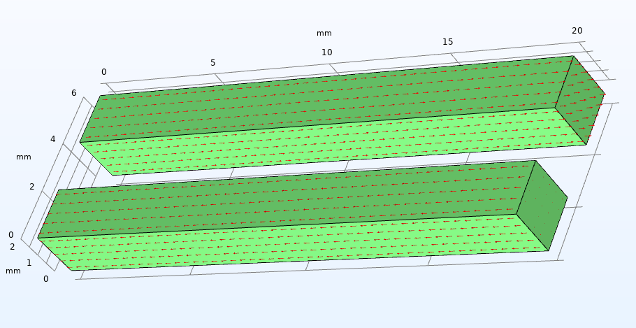

So with the Joule heatign case, it is possible to select floating potential boundaries with value of 0V which ensures continuity of current as shown below.
