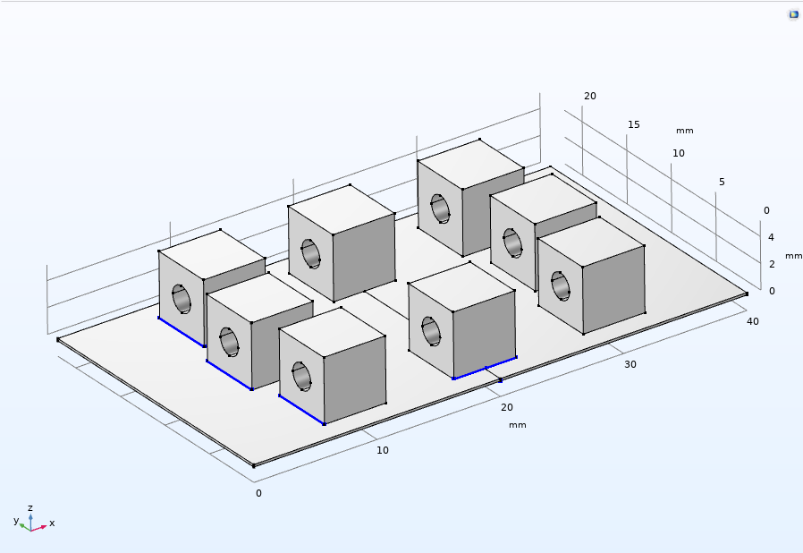

I am trying to fillet the edges shown in the attached picture. But i cannot find a fillet option. I can see a fillet option for verticies in a work plane, but no 3D fillet.

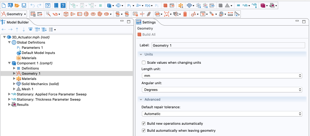

I have attached a picture to show what options i have under the 'geometry' module.

Hello Kieran,
Filletting in 3D is a feature found in the optional Design Module.
In some special cases, you can create 3D fillets without the Design Module, by using a bunch of boolean operations with cylinders, spheres, etc, see my post in this old thread, but it is not a general solution and it is very tedious even when applicable, so see if you can convince your license administrator to add the Design Module.
Best,
Jeff
