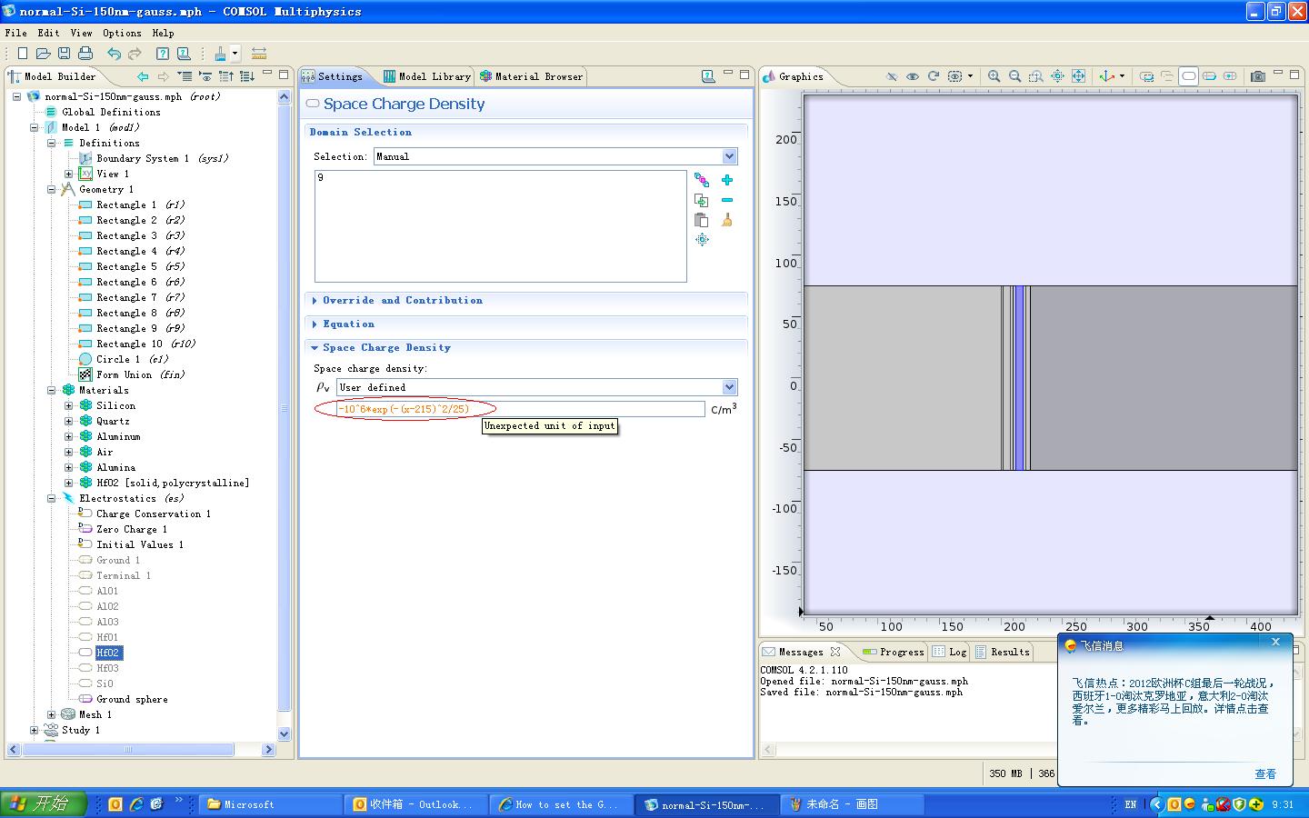

I am a freshman here. I want to simulate the potential map of a simple capacitor with a Gauss charge distribution. The model is simple but I do not know how to define the charge distribution such as -10e6*exp(-x^2/25)C/cm3. I can only set a fixed value in the "space charge density". When I try to write a Gauss expression with the variable "x", it always says "unexpected unit".
What can I do?

Thank you very much for your quick reply.
But I can not set the unit since the default unit of charge is C/cm3 and fixed by COMSOL.
Pls see the attached image. I highlight the problem shown.
PS. It is a 2D modle and left and right parts are electrodes. The dielectric is in the middle.

You can override the unit. Just insert "[C/cm^3]" behind the "10^6" factor or at the end of the expression. Only if you don't specify a unit, the default unit displayed in the right margin is used.
However, as you can tell from this explanation, the unit of the pre-exponential factor is not the issue here. Rather, you're dividing x^2 (which has unit m²) by something unitless in the exponential, so your overall unit is exp(m²), which is what throws Comsol. Instead of dividing by 25, you should divide by something like "(5[m])^2" to get the units right.
Other than that, it's usually safe to ignore the unit warnings, if you know what you're doing. After all, the solver just deals with numbers.

Yeah!
I get it. Thank you very very much.
