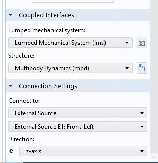

One way to do this is to use multibody dynamics and couple it to a lumped mechanical system through the lumped-structure connection multiphysics. This should allow for 2D by specifying the direction, as shown in the attached screenshot. -Mark
