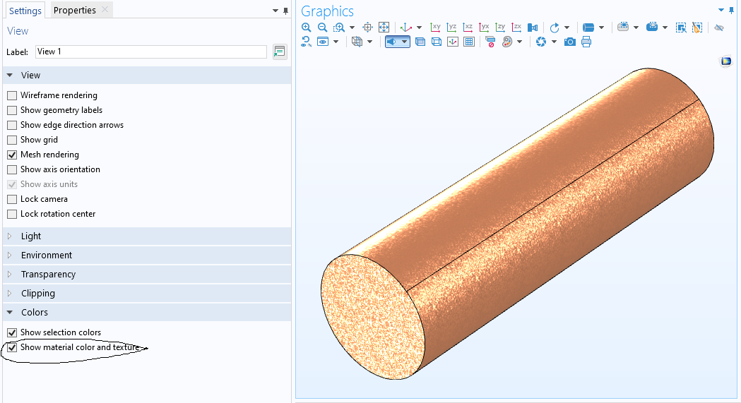

How to display material appearance in COMSOL 5.6?
In earlier versions, this can be done in Preference->Graphics and Plot Windows, but in 5.6 where is it?

You do it in the Settings window for the View node (see the attached screenshot), but you can also do it from the Colors menu in the Graphics toolbar above the plot. In the plot I have chosen Rose gold (dented) from the Material type list in the Settings window for the material.

Thank you, Magnus! The setting is so flexible.
