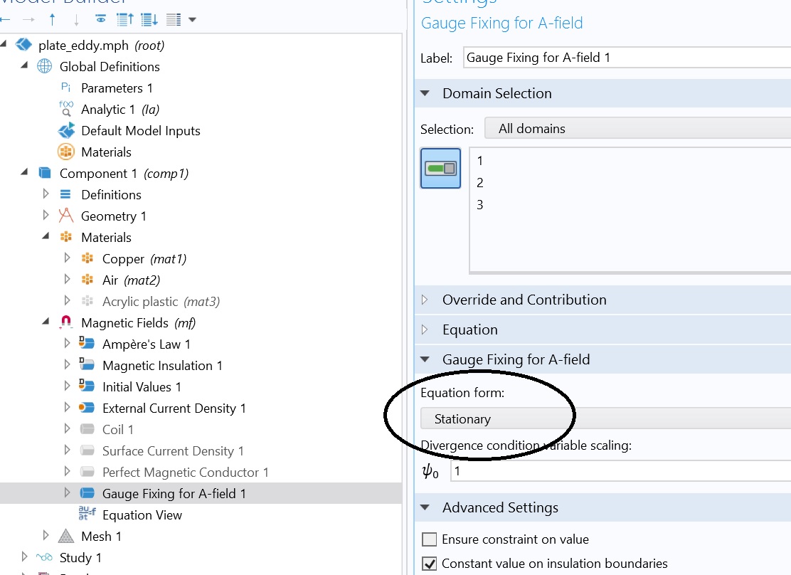

Well, I think there are a number of separate issues with your model configuration, but in regard to your convergence issue, consider fixing the gauge. See screen image attached. This should at least make all your NLFails go away (although the simulation still begins rather badly). I think you should make some other changes too, but I'll let the real experts for these kinds of models provide those suggestions. Good luck.

Dear Mr. Koslover,
I added the gauge fix as you suggested and it improved the convergence and computation time of my model. I also scaled the A variable manually by 0.001. This has solved my problem.
Thanks a lot for your time and suggestion.

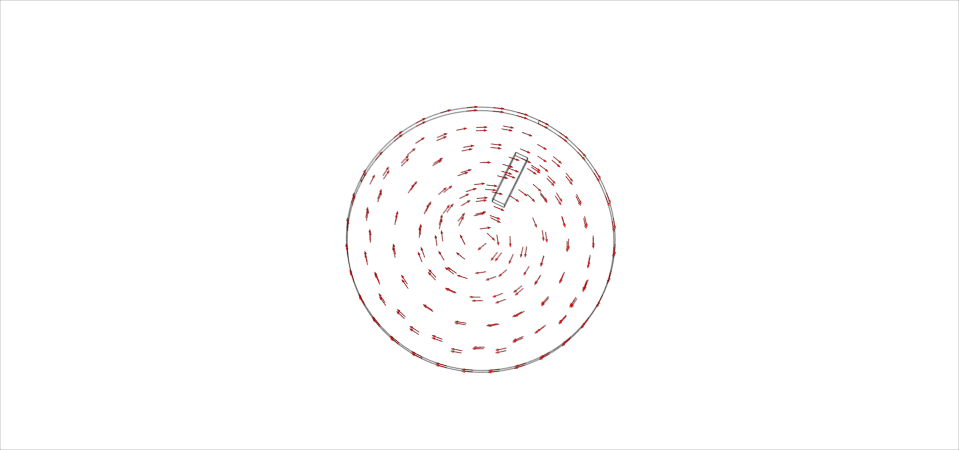

Edit: I have a doubt regarding the current flow in the plate. The image is attached herewith. Shouldn't the current be going sideways along the length of the slit and resume its circular path?
Please state if there are any other discrepancies in the model.
Thank you.

Posted: 3 years ago 8 ott 2021, 10:25 GMT-4
Please let me know if there are any other discrepancies in the model.
Thank you.
Warm Regards,
Hello, I have a doubt regarding the current flow in the plate. The image is attached herewith. Shouldn't the current be going sideways along the length of the slit and resume its circular path? Please let me know if there are any other discrepancies in the model. Thank you. Warm Regards,
