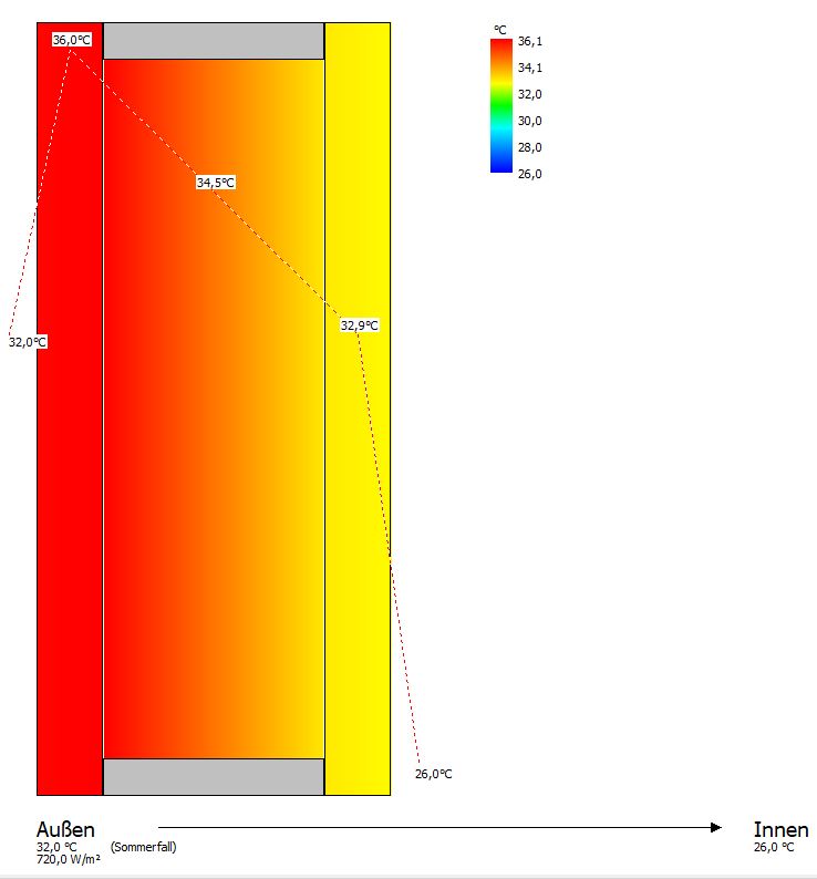

The geometry model is very simple. It consists of cube with 3 layers. Outer and inner layers are made of glass and the middle layer is filled with air. One side of the geometry is exposed to atmosphere. The irradiation value on this outside wall is 720 W/m^2. The outside temperature is 32degC. The transfer coefficient(h_ce) between outside wall and outside atmosphere is 4 W/m^2K. Conduction is observed through different layers. Temperature on the inner side of wall is 26 degC. The transfer coefficient(h_ce) between inside wall and room atmosphere is 3.6 W/m^2K. All other 4 sides are thermally insulated. There is some amount of radiation transmitted(τ = 0.9.) from outer panel. So the inner panel recieves radiation from outer panel and in turn radiates further into the room.

I expect the result as shown in the attached image. This is taken from analytical calculations from respective norms.
