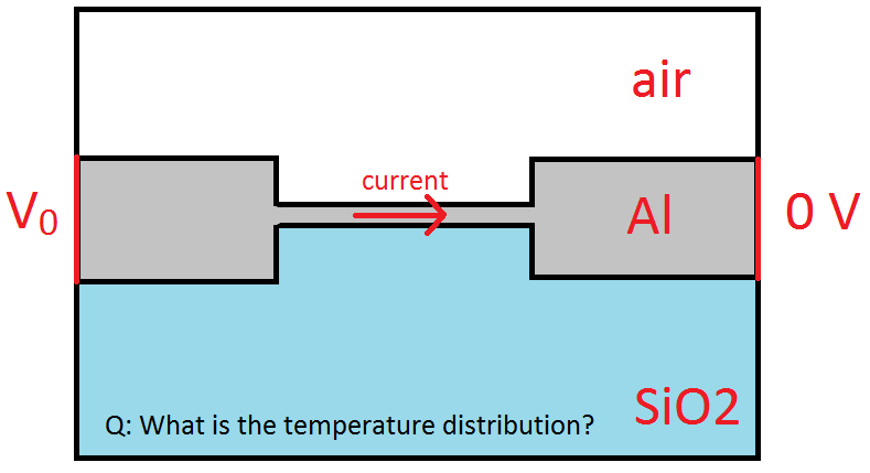

I am trying to do the simple task of drawing a 2D metal rectangle embedded in some dielectric, pass a current through, and plot the temperature distribution due to heating (which will be hottest where the bar is narrowest).
I have attached a file with a 2D metal bar between. I am getting the error "Singular matrix. There are 1806 void equations (empty rows in matrix) for the variable mod1.V...."\

Conductivity for all domains was given through the Material Browser (where I got the materials). The only thing Material Browser didn't give me was "relative permittivity" for Al.
I thought it might be helpful to attach an image of what I'm trying to simulate. It is really a simple structure, just trying to find What is the temperature distribution in a thin Al sheet sandwiched between SiO2 and air, in a 2D (cross-sectional) format.

ES (electro statics) EC (electric current) MF (magnetif field) and MEF (magnetic and electric field) are the "tag" names for the COMSOL physics, you should rather run a search on the COMSOl doc, or the Forum, you will get a better hit rate I expect ;)
I prefer to specify these tag names, as this tell us, out here, at least which dependent variables are in play, as ACDC can mean many things ;)
for the materials, the material data base might give you values, but these do not mean they are "correct" for a given physics. If you are solving for the Voltage V (i.e. MEF physics) you must have some NON-zero conductivity, even if the default of the material is "0". So if you have some "air" or water, try to set a conductivity of 1 S/m
Hi ES (electro statics) EC (electric current) MF (magnetif field) and MEF (magnetic and electric field) are the "tag" names for the COMSOL physics, you should rather run a search on the COMSOl doc, or the Forum, you will get a better hit rate I expect ;) I prefer to specify these tag names, as this tell us, out here, at least which dependent variables are in play, as ACDC can mean many things ;) for the materials, the material data base might give you values, but these do not mean they are "correct" for a given physics. If you are solving for the Voltage V (i.e. MEF physics) you must have some NON-zero conductivity, even if the default of the material is "0". So if you have some "air" or water, try to set a conductivity of 1 S/m -- Good luck Ivar
Posted: 1 decade ago 27 lug 2012, 11:38 GMT-4
That did it! Thanks! Would be good to have a more helpful error message which would see if you set conductivity to zero and just warn you.
