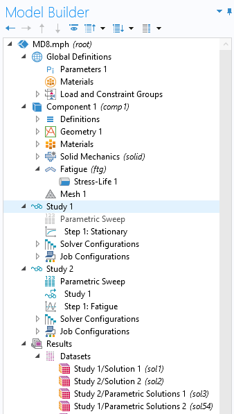

Hi all, I am doing a Fatigue stress based analysis of a tuned mass dampener with the end goal of obtaining S-N Curve (or Wöhler curve) to determine the relation between Stress and number of cycles to failure for my geometry. I used the findley's criterion and successfully coputed fatigue usage factor but not able to figure out the way to obtain number of cycles to failure.
Can someone help me by telling if (and how) I can get this in Comsol or am I supposed to use other software for this purpose?

Thank you Mats. I was able to get number of cycles for a range of load (using parametric sweep), but to plot them in an S-N curve I need stress data from the result of Study 1 (Stationary analysis) and number of cycle data from Study 2 (Fatigue analysis). Is it possible to plot this graph in Comsol or the only way to do it is to export data and use other plotting software to do that. I have attached my model builder sceenshot for reference ?
