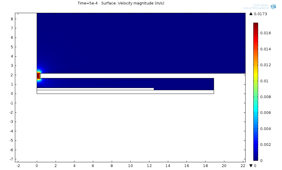

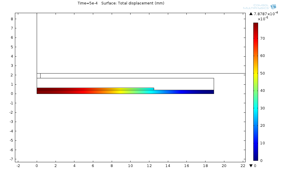

I think you fall into a trap that you have to use Piezoeletric Devices and Fluid-Structure Interaction.
As you know, there is no Piezoelectric Material Domain Settings in Fluid-Structure Interaction. This is the first problem you had. So, to consider both Linear Elastic Material and Piezoelectric Material Domain, you need to change all applications. These are,
1. Piezoelectric Devices to consider both Cu and PZT-5H
2. Laminar Flow to consider Air
3. Moving Mesh to consider both air and solid
4. Boundary ODEs and DAEs to consider solid velocity
5. Time Dependent Solver
And, physics couplings are,
1. air acts on the surface of solid : use the boundary load
r-term : spf.T_stressr*dvol_spatial/dvol
z-term : spf.T_stressz*dvol_spatial/dvol
2. in fluid, wall : moving wall : solid velocity from ODEs settings on the interface of the air/solid
3. define the solid velocity in ODEs. if solid displacement is u and w, solid velocity is ut and wt where t means time.
4. In moving mesh, use 1. prescribed deformation to consider solid displacement, 2. prescribed mesh displacement to consider solid displacement & axial symmetry.
