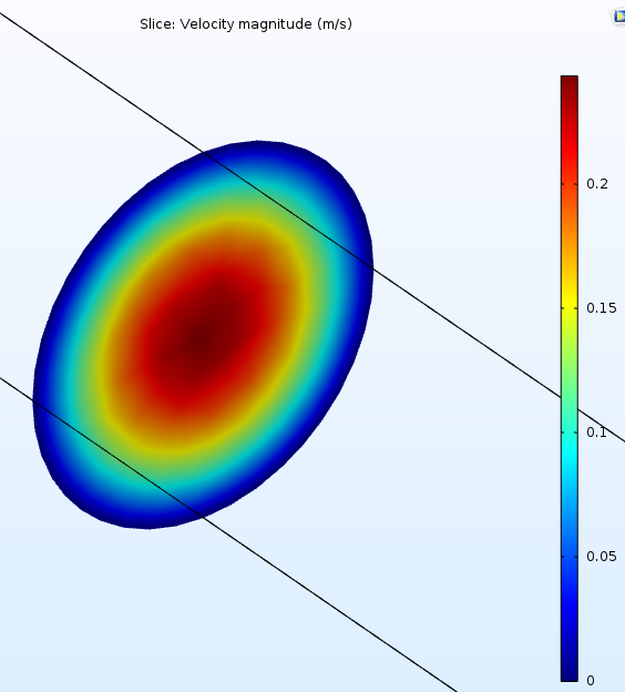

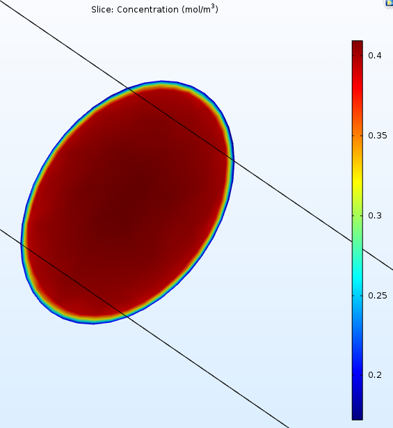

To simulate laminar flow reactors, I started with the simplest case. Straight tube, laminar flow, first order reaction, steady state. I used “Laminar Flow” and “Transport of Diluted Species” (only convection, no diffusion). Results for velocity field are fine, showing a consistent radial variation; however, the radial distribution of the reactant concentration is flat, as if it was a plug flow reactor (pictures attached). This result in not coherent with a laminar flow velocity profile.

Hi Lasse, thank you for your reply. I am simulating in 3D because I want to model a helically coiled tubular reactor. I started with a straight tube to check model consistency. Since diffusion is zero, this LFR has segregated flow (microfluid with no mixing). Consequently, there should be a clear variation of concentration with the tube radius.

What I saw is that the reaction rate is so high that entire concentration is consumed within first centimetres. Because there is no radial concentration distibution in the inlet, it has no time to develop because the concentration is zero most of the length of the tube. At which lengths are your concentration distribution plots (slides)?

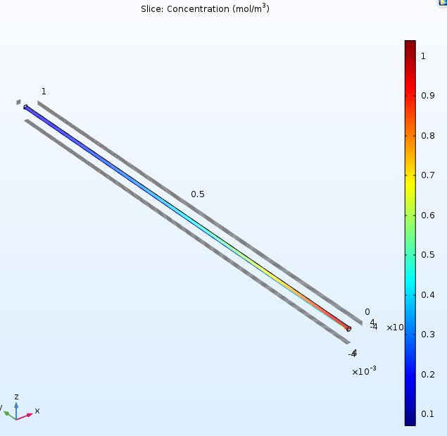

The original file 'Radial concentration distribution.png' is a slice at the middle of the reactor. A horizontal slice in the attached pic shows that concentration fall gradually from 1.0, and is around 0.4 in the middle (z=0.5 m). Mean residence time is 8s. Plug flow with k = 0.23 1/s would result in concentration of 0.32 at the middle and 0.16 at the outlet.

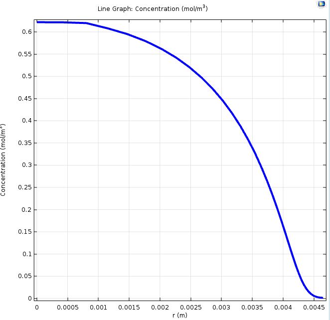

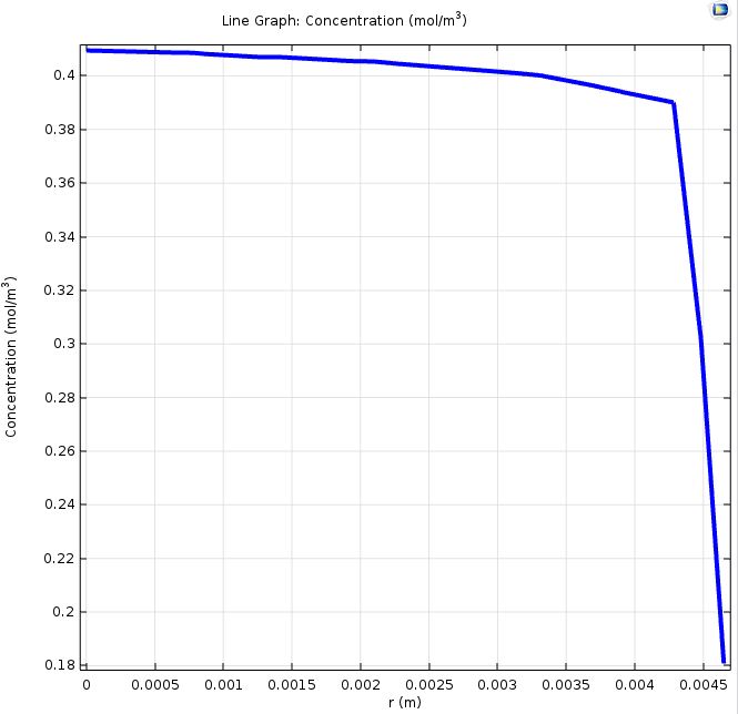

For comparison, I successfully solved the problem as 2D axisymmetric, Mapped mesh. Only interface used was “Transport of Diluted Species”, inserting expression for laminar velocity profile. Attached are pictures of the radial concentration profile at z = 0.5 (middle of the reactor), from the 2D model (coherent) and from the 3D model (incoherent). Maybe the problem is in the 3D mesh...

Posted: 3 years ago 25 mag 2022, 19:37 GMT-4
Problem solved when I changed the unstructured free tetrahedral mesh to a structured swept mesh (see picture).
