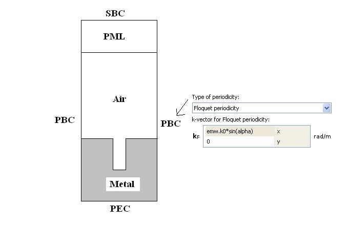

For a metal grating (see attached Structure_Reference.jpg), now I would like to analysis the dispersion relationship of surface plasmon wave supported by a metal grating, which propagates along the surface of the grating.
I choose Eigen-frequency analysis method:
I set left-right boundary as periodic boundary condition with Floquet periodicity (the related setting as well as other boundary conditions see Structure. JPG);

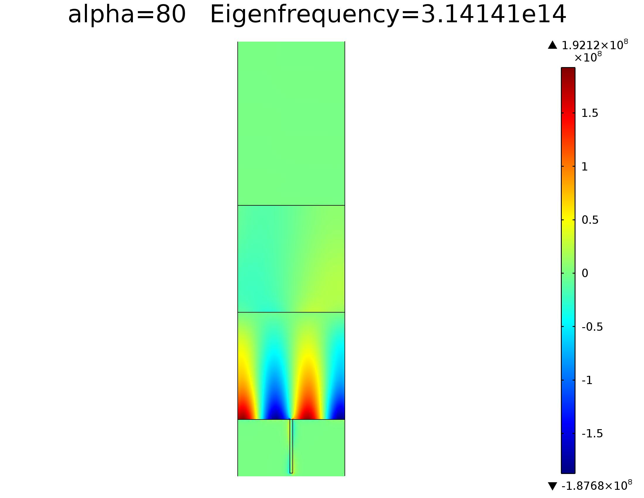

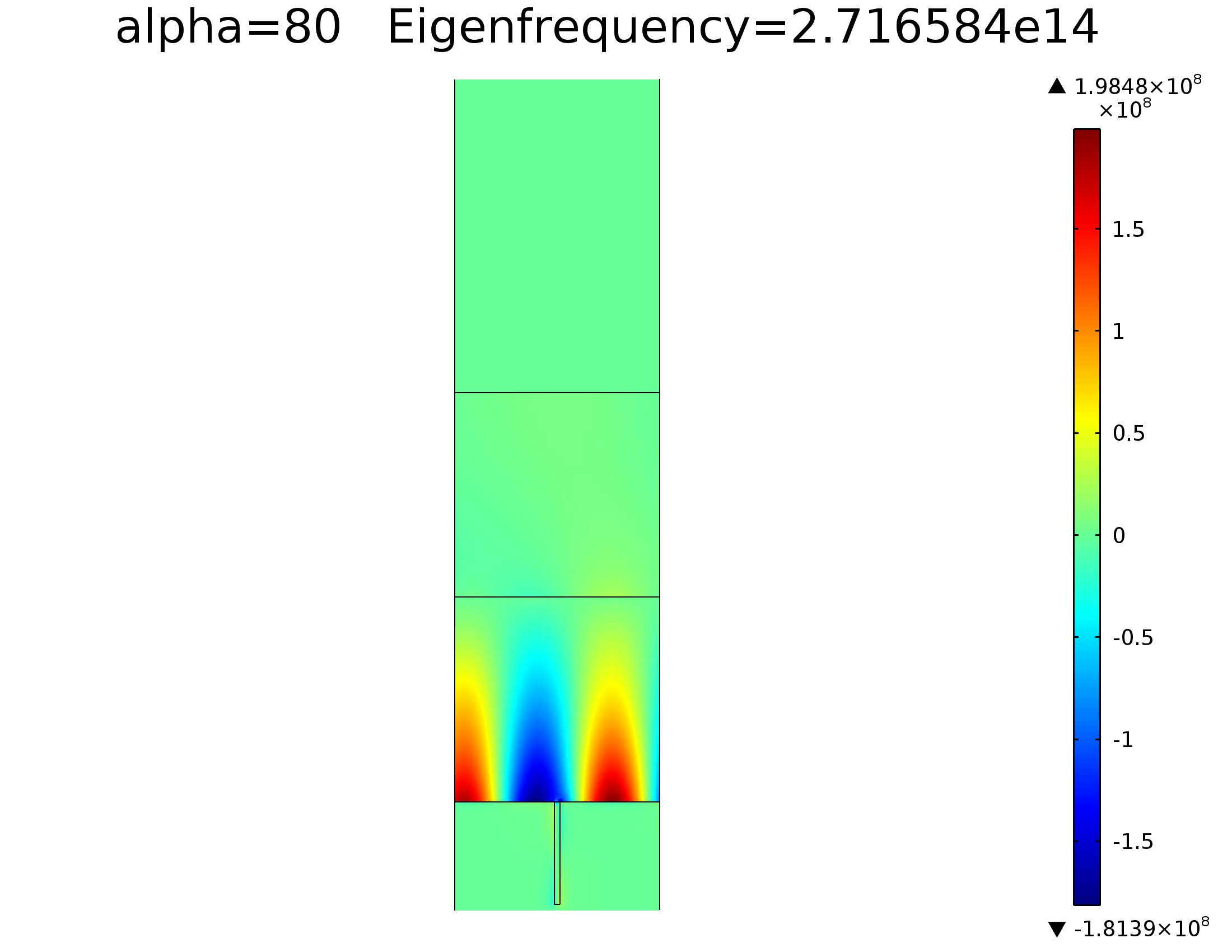

Here giving an example, when alpha is set as 80 degree, then the related eigenfrequency of surface plasmon mode is analyzed, the corresponding field distributions are see attached (a.jpg and b.jpg).
From the distributions, we can see that they are indeed the surface plasmon wave supported by the structure.
Then the dispersion relationship can be obtained simply based on these eigenfrequency values.

Posted: 1 decade ago 9 ago 2012, 14:51 GMT-4
I'd include PML on the bottom as well. Other than that, everything seems fine.

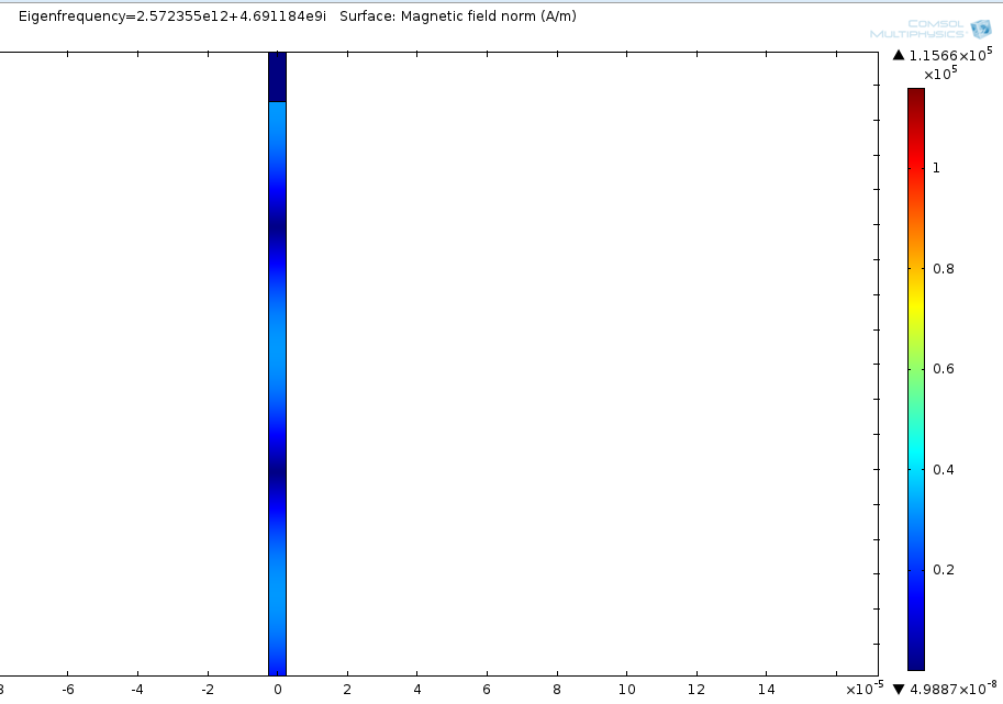

Posted: 1 decade ago 4 dic 2012, 16:44 GMT-5
Marvin (or anyone else who may have ideas),
Can you explain in some detail how you set up that PML at the top? I'm performing a very similar simulation with a dielectric waveguide at the bottom rather than the SP waveguide and I can't figure out how to set up the PML. I've attached a screenshot that shows the upper portion of my air domain on top of the unit cell and the PML at the top. The magnetic field of one of the eigenfreq solutions is shown in the attached image. It appears as though the boundary between the PML and the air is just a PEC.
How did you define the boundaries? Is meshing important? Do you generally have to provide any inputs, or do you just add the domain, designate it PML and solve (it seems that's all they do in the tutorials)?
Any advice would be appreciated, thanks.
Chris

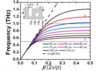

You might want to take a look at this video to calculate the dispersion curve based on eigensolver
www.youtube.com/watch?v=HMgdXMNigCA

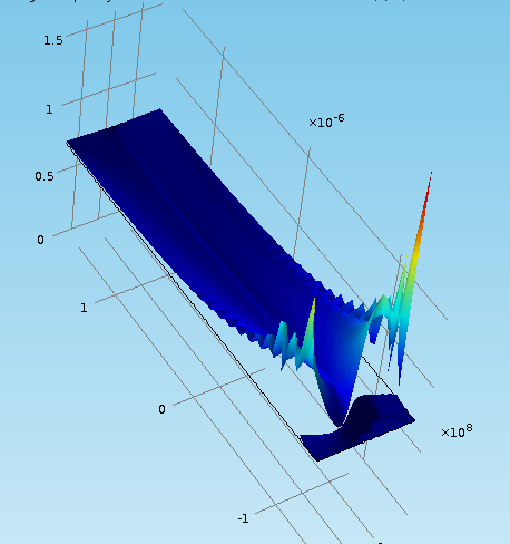

Posted: 1 decade ago 6 feb 2015, 06:30 GMT-5
Did you try to smooth the corner of the grating? For example, using a grating of sine shape. I can reproduce your result. But when I use a sine shape grating, the field near the Floquet boundary show much fluctuations. Do you know what's wrong with my model? Thanks
