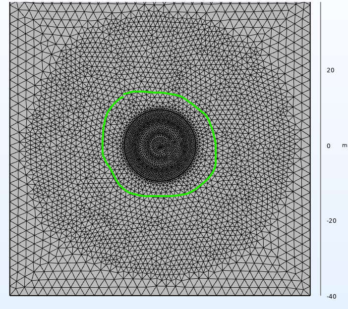

I would like to make the mesh finer in just certain locations of my 3D mode. In the image attached, I would like to make smaller tetrahedrals just inside the area delimited by green cicrle.
How do I do that>

It seems as though you already have a finer mesh within a radius of about 10, so all you need to do is create another circle with a radius of about 15 (to correspond to your green circle) and define a size subnode within your mesh sequence corresponding to the new domain.
Or am I missing something?
There are a number of ways to do this depending on the physics you are trying to capture. A Mesh Control Domain (created using a virtual op in the geometry node) could be used if the geometry within which you require mesh control is not a physically separate boundary condition/material.
