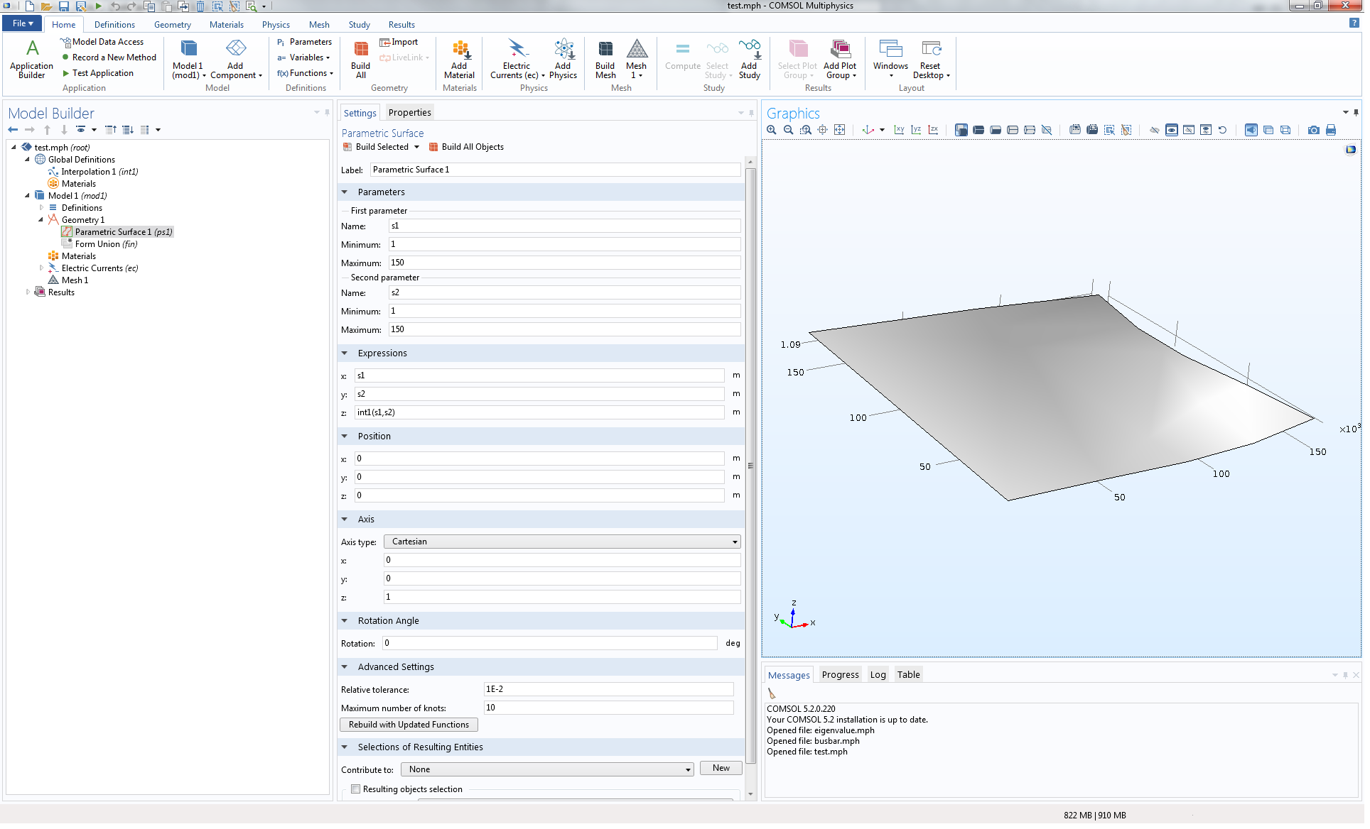

You may want to update your license to the current version: in 5.2 your file works right out of the box, see screenshot attached.

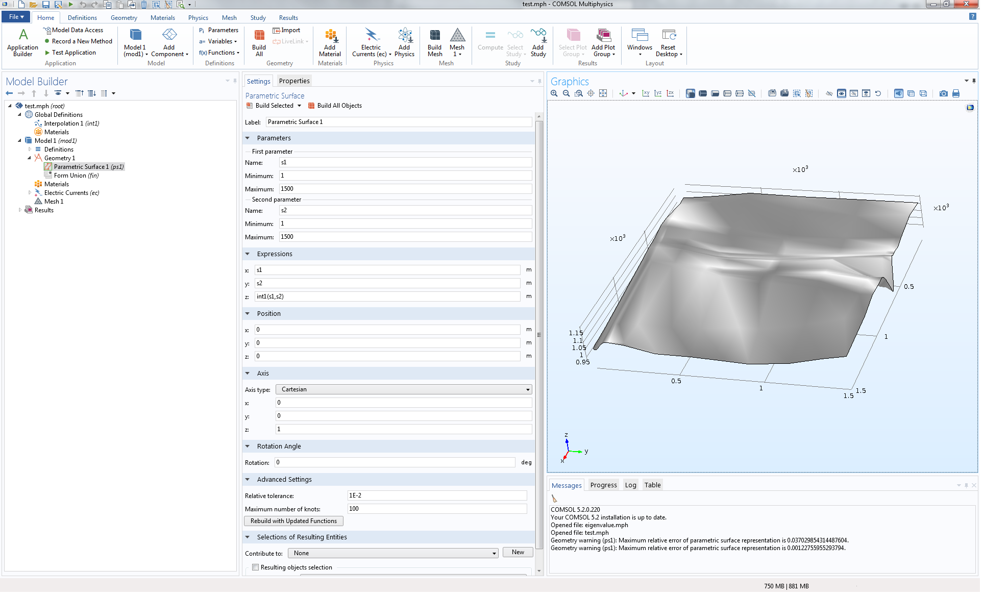

thanks for the fast reply. We have thought about updating our license but it we do it will still take a while. Do you know where the mistake lies for the 4.2 version? Oh and as I see from your figure: The parameters s1 and s2 range from 0 to 1500 each not from 0 to 150. (In my model it does not make a difference - I still get the same errors or wrong topography). Could you maybe attach a figure with the right ranges just for me to check that with the newest version the topography gets displayed correct?
Thank you!
Sorry, I don't have 4.2 any more.
Attached is the screenshot after I increased the ranges for s1 and s2 to 1500. You'll notice that I increased the number of knots from 10 to 100 to capture your elevation data better.
