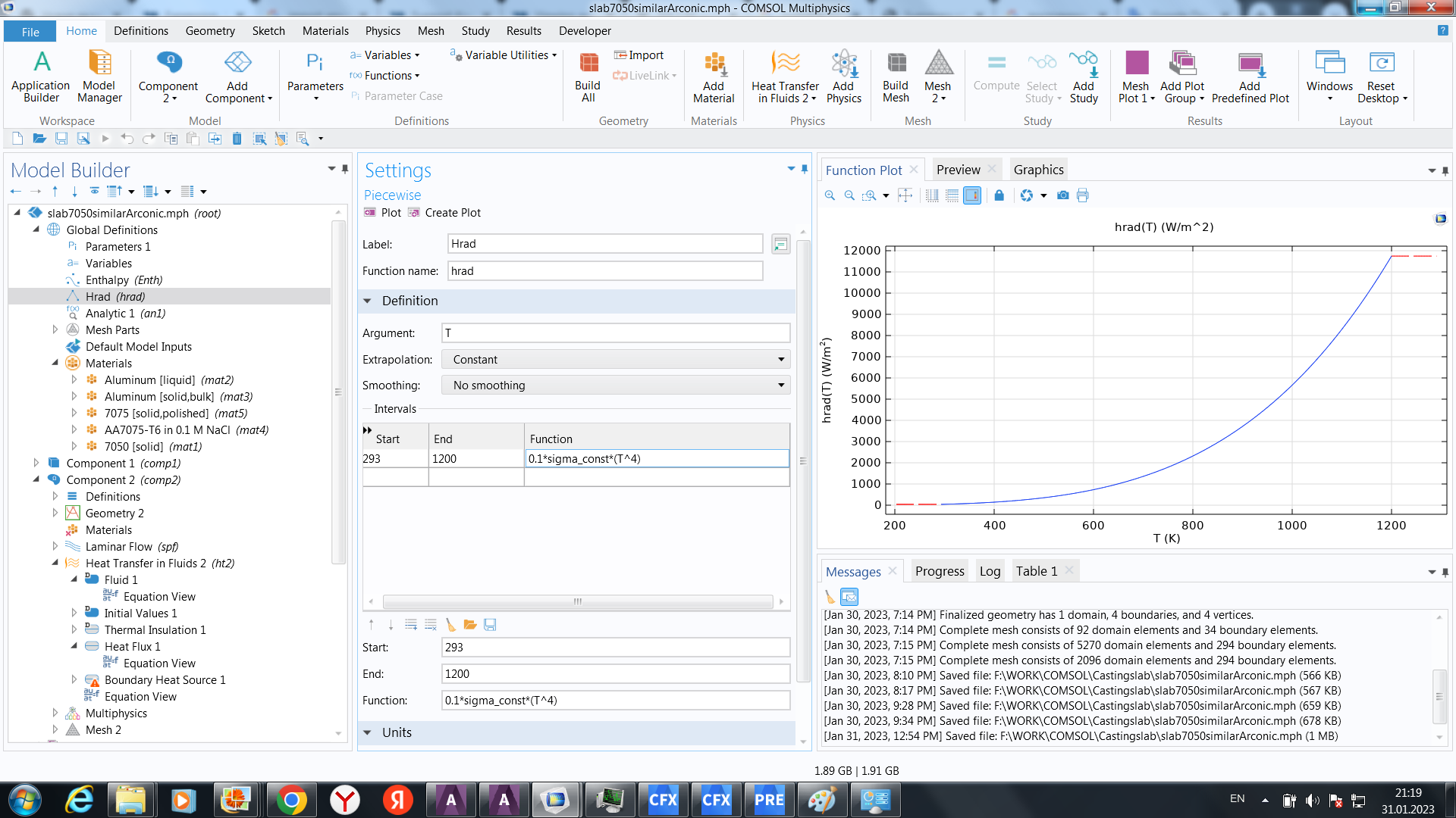

I see the big possibilities for using Expression and Function for flexible define BC, matherial properties and etc, but with my huge expirience i have strange problem for my works with Espression in the Comsol. For example i want to define Piecewise function for radiative emisivity BC for walls, and i define hrad function with argument T is 0.1*sigma_const*(T^4 - 293^4) and interval for T. But Comsol not calculated the part of expression "-293^4" and results the same for "-293[K]^4" and etc, for example 0.1*sigma_const*(T^4)- 0.1*sigma_const*(293^4). The plot graph for this function calculated only for T argement and absolutely ignored all other. Where i can see the principles (algorithm) for correct defining of expresions? Please help me. As well, becasue Expression field absolutely don't has contects help (For example Ansys CFX preprocessor has a prefect help for all variables and etc in the field for formula), I'm as a user not understand what i may to do in the Expression field. The help of Comsol in laptop version is too small and i want to find the all list of operations, variables and etc (include from results solutions) which i can to use in the expression field. Please help me. Give me please the links to webinars,papers and other Comsol web helps, where i can see it clear.

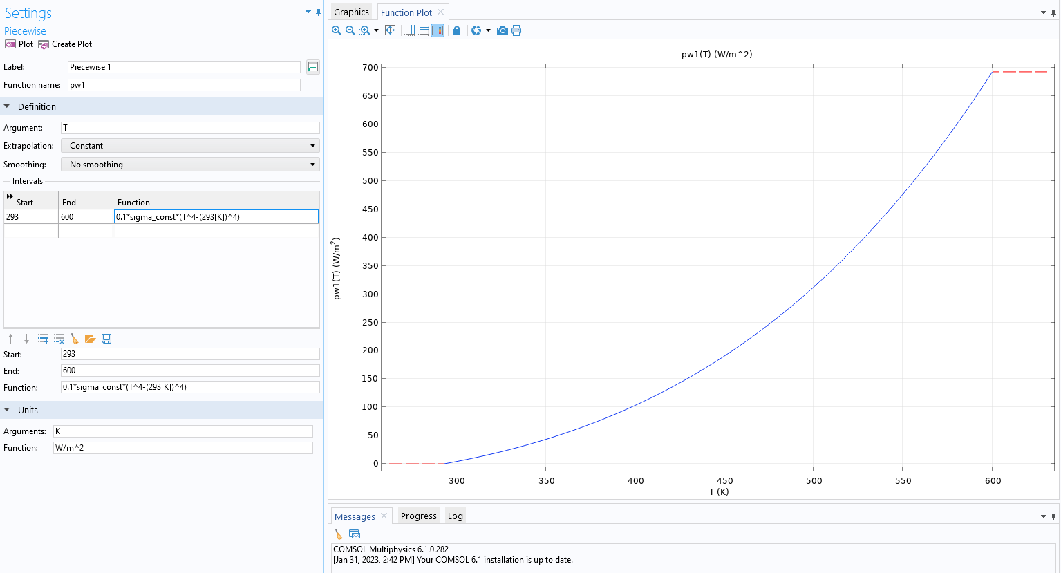

You can see on the screenshot (Screenshot_1.png) that Peicewise function works correctly.

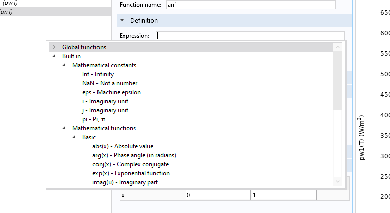

It's not exactly the case. With CTRL+Space shortcut you can open the list of parameters, variables, functions and operators that you can use in Expressions (see the Screenshot_2.png).

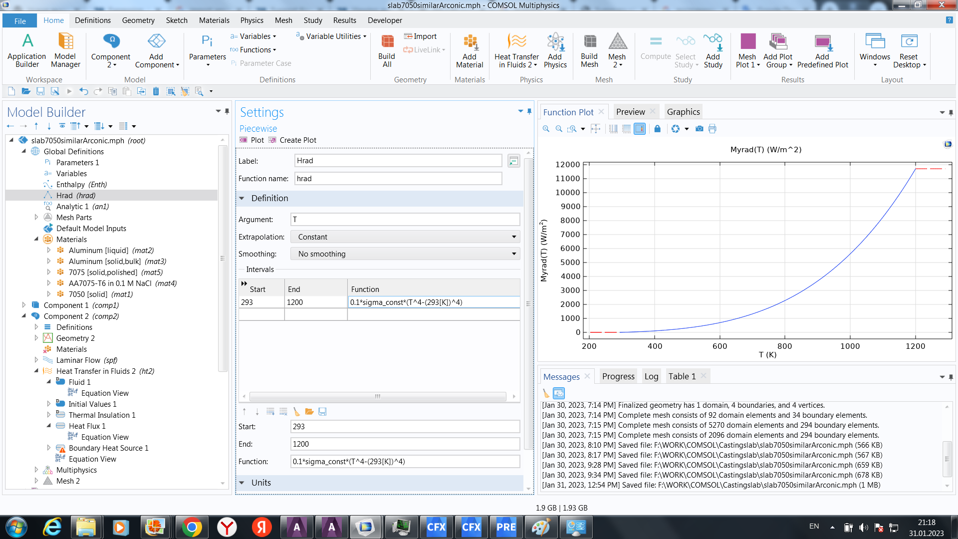

Thank you for you quick reply 1. Yes, context help is working by CTRL+SHIFT, but only for Expression field not for Function. 2. Please see the results of calculation fuction on my laptop... The both function gives a equal results. It is too strange, may be it my error and i'm a stupid. 3. Please help me and show (give) the direct link to paragraphs in your link ( https://doc.comsol.com/6.1/docserver/#!/com.comsol.help.comsol/helpdesk/helpdesk.html), where i can find the complete list of all variables, operators and etc which i can to implement in Expression and Function field.

In the "with" screenshot, the plot is of a function called Myrad, not hrad. Could that be the issue?

"Myrad" it was previous function name before correction. I have change the name and at any case results the same - not correct. After your message i repeated few time to calculate - negave. I'm confused, the my version of Comsol is last - 6.1.0.282. This is a error of system i think, because the d(Enth(T),T) not working as well (my other forum topic). I'll thinking...

I see the plot change, albeit subtly, at 0:40 in your video.
Note that T^4-293^4 is not very different from T^4 when T>300 (T^4 grows very quickly and dominates 293^4). When T<300, the 0.1*sigma_const multiplying factor causes both expressions you're plotting to be essentially zero and therefore visually indistinguishable.

It is correct. The values is too big and "covered" the small "-293^4" addition. This issue is closed "d" operator not working on Win7, and I'm update to Win 10. Now all working.
