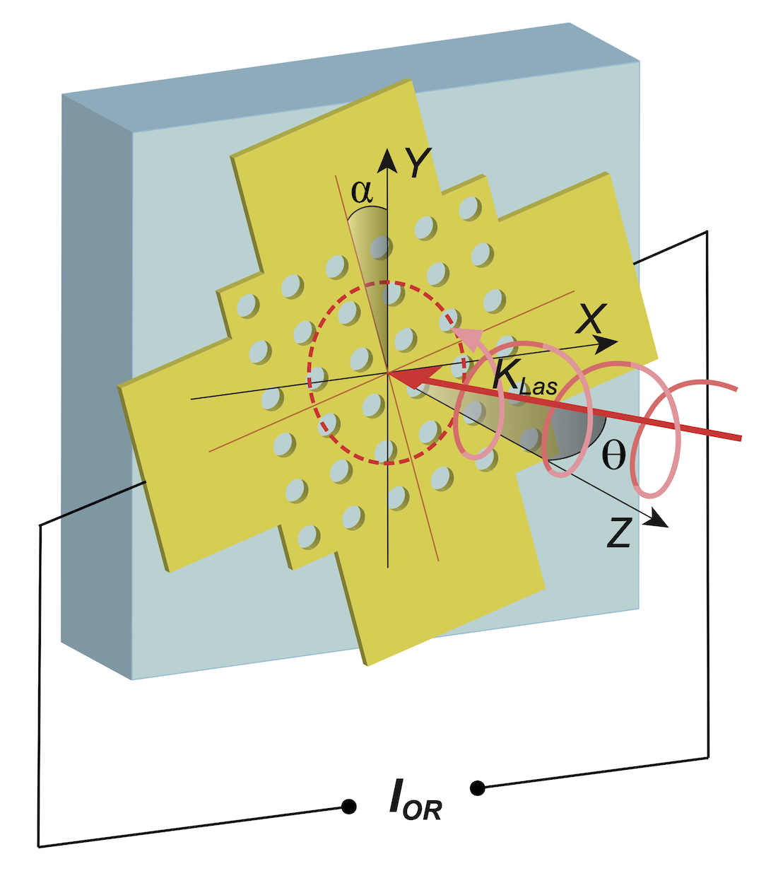

I tried to model the effect of circular polarlized light on a 2D hole array with some angle of incidence. In the input port, I chose periodic port and set the electric field to be to make a circular polarized light. However, at a high angle of incidence (>40 degree), the total of reflectance, absorptance, and transmittance is higher than 1 which doesn't make sense. Is this the correct way to make a circular polarized light?

  2. I'm confused by your 3-component specification of the electric field. Do you have detailed pictures of your geometry, the desired incident wave-vector (k) direction, and your coordinate system?

My .mph file is too big but this is my structure.

Well, I don't have the wave optics module, but now I can see why you want to use periodic ports (which will model an infinite array -- this may differ somewhat in behavior from the finite array in the earlier picture that you posted). Anyway, it helps the forum that you posted the model. I encourage those who have the wave optics module to take a look at your file and to offer suggestions.
Well, I don't have the wave optics module, but now I can see why you want to use periodic ports (which will model an *infinite* array -- this may differ somewhat in behavior from the finite array in the earlier picture that you posted). Anyway, it helps the forum that you posted the model. I encourage those who have the wave optics module to take a look at your file and to offer suggestions.
