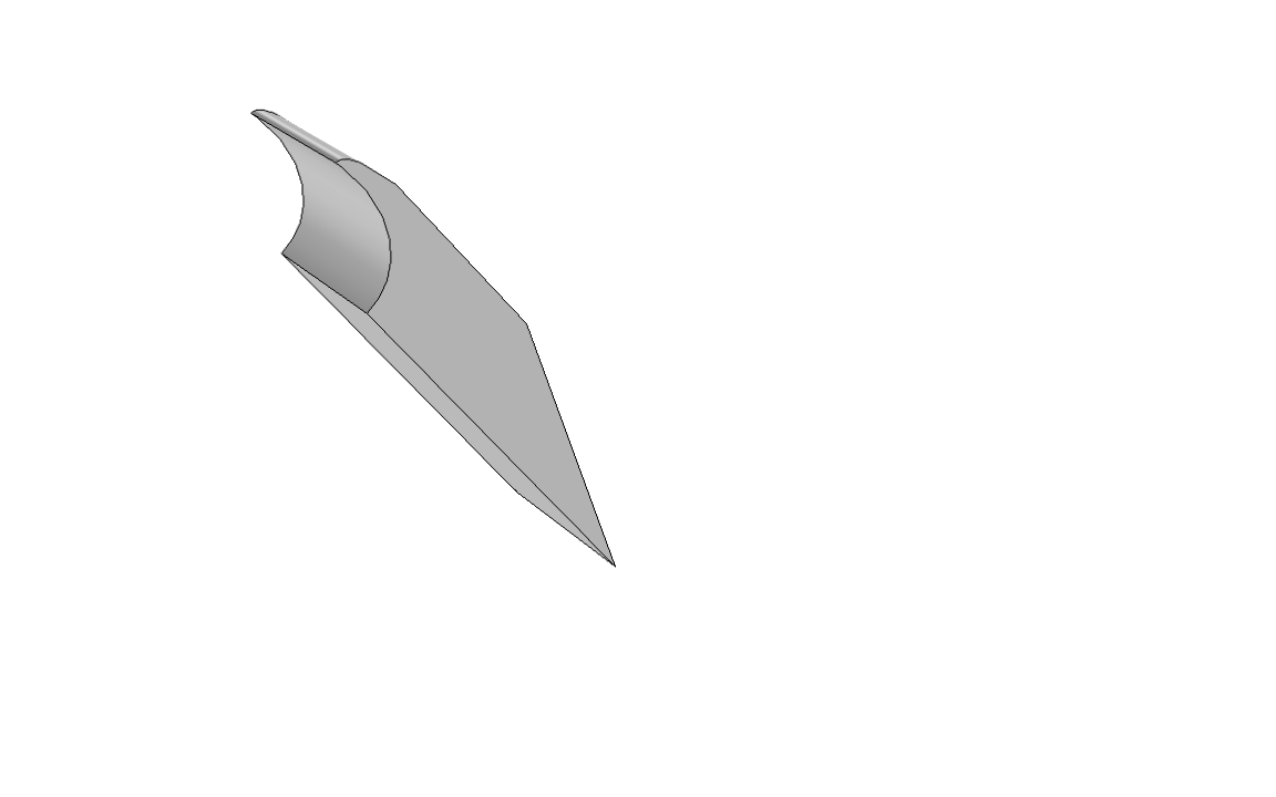

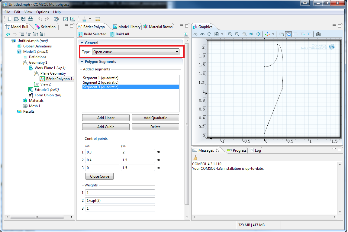

2-) Right-click Model 1>Geometry 1>Work Plane 1>Plane Geometry and add a Bézier-Polygon which can be piecewise linear, quadratic or cubic. (screenshot1.png). If you would like this curve to be closed (to be a surface), just change the type.

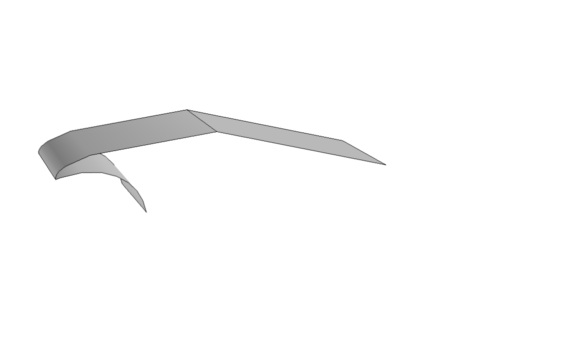

3-) Right-click Workplane 1 and choose Extrude -> You have a surface (solid, if you chose closed and solid in 2-)) in 3D.

when you are in the Bezier Polygon, in the settings window (the one in the middle of the screen), on the top, just under "general", it says "Type", and you can choose Solid, Open Curve, and Closed Curve.
That is what you want

Well, choose Solid ;-)
