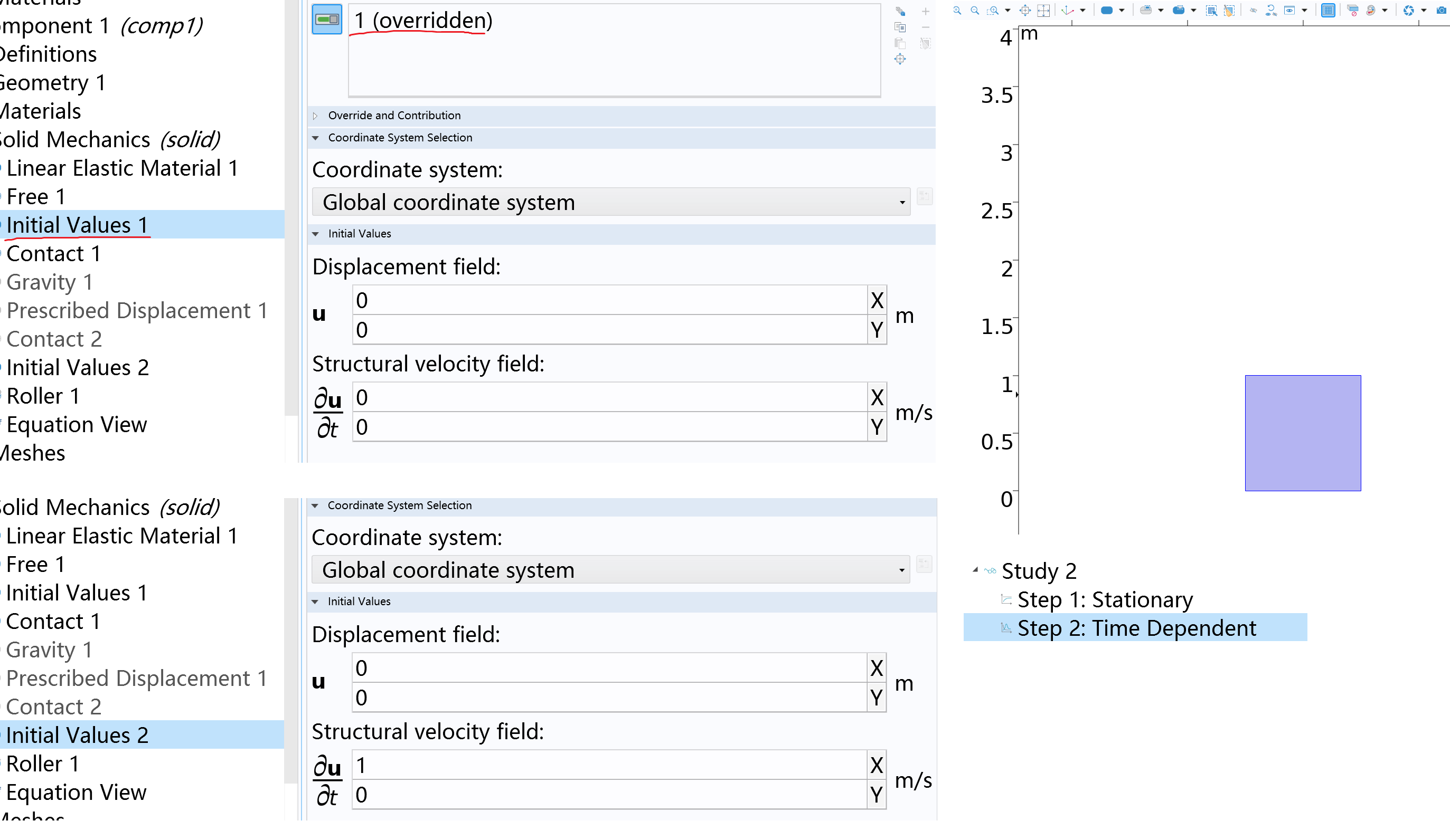

Thank you Dr Sönnerlind. I strictly follow your advice (In step 1, disable the second Initial Condition node under Modify model configuration for study step) as in the attached figure. But the block never moves. It seems that the second initial condition isn't applied at all by the software.

Will the interface of "values of dependent variables" and " Initial values of variables solved for" be relevant to this question?

That is correct. You need to take initial values from User Controlled -> Initial Expression in the second study. The default is to use results from the previous study as initial conditions.
