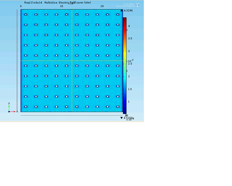

I was trying to see electric field enhancement in gold nano foil (30nm) with subwavelength size holes (25nm). I had a structure as shown in figure I applied scattering boundary condition and electric filed of E=1 in y axis, I got electric field enhanced up to 4.3 but this is at the center line dividing the structure in 4 parts as seen in figure. I dont know why electric field enhancement is like that and I'm not sure the value I'm getting (4.3) is enhancement in applied electric field by 4.3 times or not.
Hi, I was trying to see electric field enhancement in gold nano foil (30nm) with subwavelength size holes (25nm). I had a structure as shown in figure I applied scattering boundary condition and electric filed of E=1 in y axis, I got electric field enhanced up to 4.3 but this is at the center line dividing the structure in 4 parts as seen in figure. I dont know why electric field enhancement is like that and I'm not sure the value I'm getting (4.3) is enhancement in applied electric field by 4.3 times or not.
