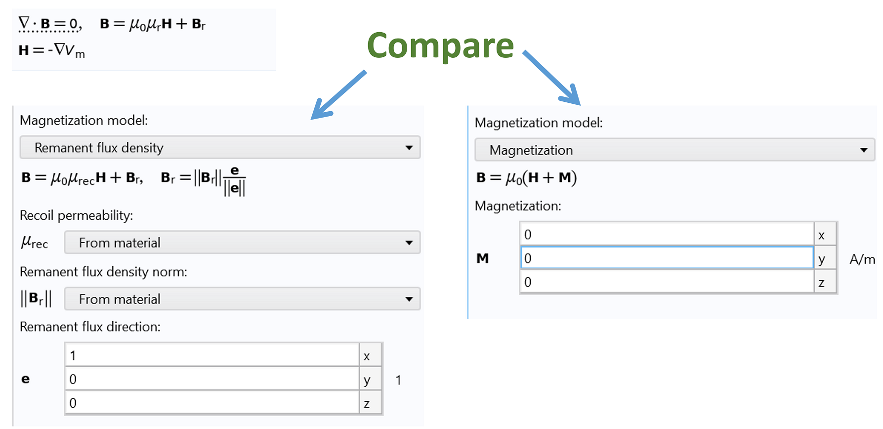

Hi,everyone, Can someone help me? Under the magnetic flux conservation node of mfnc module, the simulation results of magnetization and residual magnetic flux density in the magnetization model are very different. How to choose the magnetization model for static magnetic field analysis? Thanks!

There is a difference. See the attached figure, showing screen shots of the equations, taken from the two different settings you mentioned. For a more detailed discussion of the physics, I recommend the text: "Permanent Magnet Materials and their Application" by Peter Campbell.
