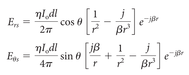

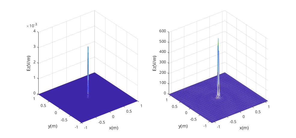

The closed-form expression is evaluated using the attached Matlab code, which implements the equations in the attached image in spherical coordinates and transforms the fields to cartesian coordinates. The absolute value of the field along the Z direction is plotted for the 2D slice at z=0.
Problem: The absolute values of electric fields are drastically different.
Question: Why is there a considerable deviation in the amplitude of electric fields? Is there anything wrong with the Comsol settings or the code implemented?

Just a couple quick guesses here: 1. This entry at the top of your .m file appears suspect: "epsilon0 = 8.85418782 " What happened to the 10^-12 factor?
2. The IdL dipole moment in your .m file is .01, but .001 in your .mph file, I think. Take another look at that too. 3. There are other features of your model I would probably investigate further and adjust, but let's start with those two items. I hope that helps.
