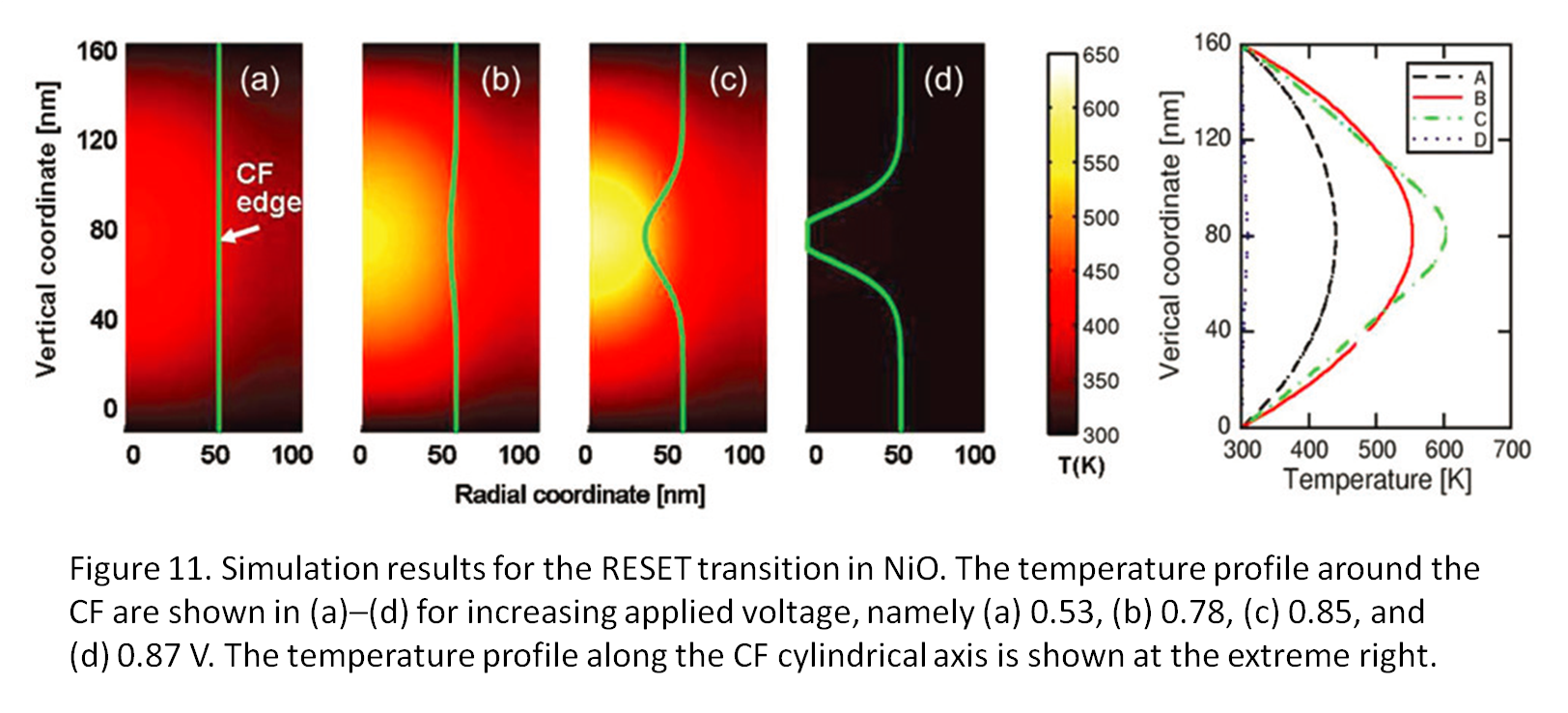

Dear all,
I would like to ask some help about a simulation that I am trying to implement. I think I have similar problems with the one presented in the thread, but not completely sure.
My simulation is the following:
My system is made of two different materials, one is a good conductor, the other one is a bad one. The good conductor has the shape of a filament sourrounded by the other material.
When I apply a bias current is flowing and the filament heats up faster than the bad conductor because almost all current is flowing through the filament. I make a time dependent simulation where the bias is time-dependent.
This is basically a simple multiphysics current/heat simulation.
The point is that the filament is degradated by the boundary temperature. In the model this means that the internal boundary between the good and bad conductors changes in time depending on the boundary temperature with a velocity which is a function of the temperature.
In other words, I have a coupled time dependent simulation (heat/electrical) with variable internal regions for the two materials which depend on the temperature.
I wonder if this part can be added to the simulation and if yes do you have any suggestion how the boundary dynamics can be implemented within COMSOL 4.2?
Best regards
Alessio

Hi Ivar,
thanks again. I will try to be clearer in this email.
Imagine a filament sourrounded by a second material. Current is flowing and heating the filament as well as the other material. However, most of the current flows inside the filament, then it should heats up more than the other material.
In particular I have a temperature field at the boundary between filament and sourrounding material.
What I need is to change the geometry of the filament (it shrinks its diameter with a velocity which depend on the temperature, something like dr/dt = f(T(r), t), with r= radius of the filament at time t) and T(r) the temperature at the boundary.
In theory after a certain time the filament should break as the filament in a light bulb, however I know that this is a topological change of the geometry and could be difficult, I just need to know the velocity of filament shrinking at different sweep velocity of the bias in time and as function of maximum bias reached (imagine to apply a triangular bias weep to the device: the sweep reaches a maximum bias in a certain time).
The volume left empty by the filament shrinking is filled by the sourrounding material...in other words the boundary between the two materials should change in time with the function dr/dt = f(T(r),t). I attach a figure with caption took from a paper that make a similar simulation. In the figure the green line represents the variation of the filament diameter in time (at different biases) as a function of the thermal heating. The more the filament heats up, the faster the diameter drops. the figure comes from (Phase Transitions Vol. 84, No. 7, July 2011, 570–602).
I wonder if something similar could be implemented within COMSOL 4.2. I have a discrete understanding how to couple the thermal and electrical parts, but for the inserting of the dynamic change I really don't know.
Best
Alessio

Hi Ivar,
thank you very much for the many advices. Actually I menaged to get what I wanted using partially this thread and partially another one (I don't remember the exact title) where you explained how to simulate the bending of a capacitor induced by the charge!
I used ALE (on top) coupled to EC and HT simulations, putting a temperature dependent formula on the boundary between the two materials. And it works!
there is still a lot of work to do to generalize in 3D, get all the right parameters, but I think I am on the right track.
Thank you very much for your help :)
Best
Alessio
