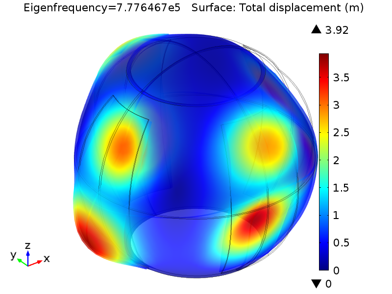

Posted: 1 decade ago 15 feb 2013, 10:37 GMT-5
Joan,
I noticed that your geometry has intersecting faces. Attached is corrected geometry and eigenfrequency solution.
Sergei
Joan, I noticed that your geometry has intersecting faces. Attached is corrected geometry and eigenfrequency solution. Regards, Sergei
