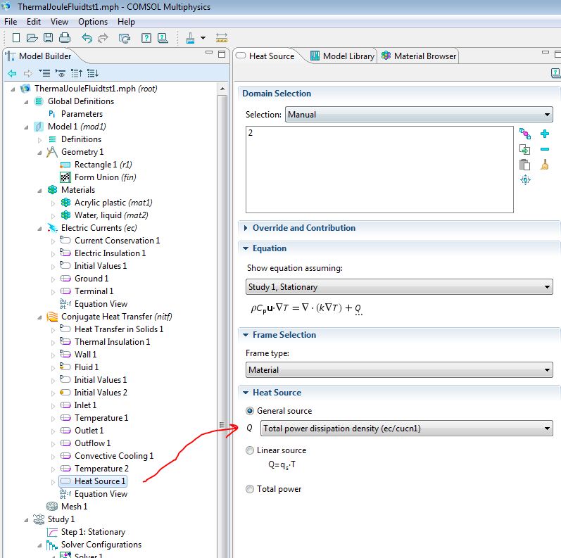

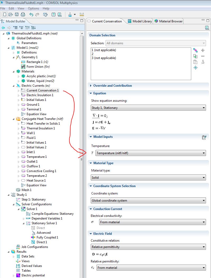

Posted: 1 decade ago 21 feb 2013, 02:58 GMT-5
you must ensure you turn the links on between EC and NITF once in EC for the temperature (Current conservation node), then you need to add a heat sorce in the NITF fluid domain linked to the EC Joule heat dissipation
I use NITF as this has solid, and fluid heat exchange included (Solid+HT+SPF combined physics)
I have added a v4.3a example model (I do not have any earlier versions running)
Hi you must ensure you turn the links on between EC and NITF once in EC for the temperature (Current conservation node), then you need to add a heat sorce in the NITF fluid domain linked to the EC Joule heat dissipation I use NITF as this has solid, and fluid heat exchange included (Solid+HT+SPF combined physics) I have added a v4.3a example model (I do not have any earlier versions running) -- Good luck Ivar
