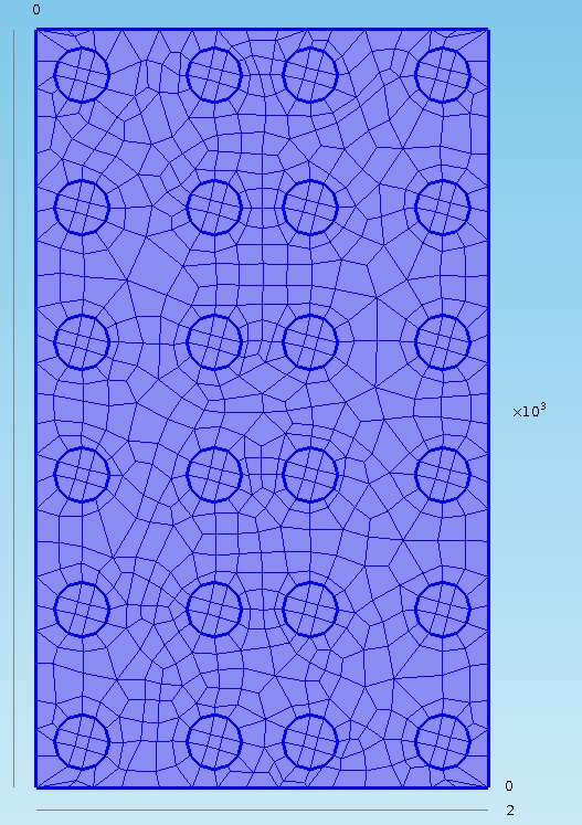

Thanks for your reply already. So ill try to create a good model for my case. In fact i dont want to use a constant area load, even more id like to initiate the load with 24 stamps (circular arrays in the picture) wich are closer to the real load. At the end i want to make a cut in the middle area to visualize the tensions beginning at the stamps. So i just created the pattern with a new workplane and now im trying to make a good mesh.
Wich mesh would be best for a couple of thin layers? The heights of the layers varies from 3.2 mm to 0.2 mm, wich element size should i take? I thought about aspect rations of 1/20 or 1/50 element size so id take maximum size elements for the 3.2 mm layer of 160 and for the 0.2 mm layer of 10.
My problem is when i make a free quad-net and try to extrude it from top surface where the layer with the stamps is on to the botton surface i usually get errors telling me the extruded net couldnt be created for the area because the origin and target area do not fit together.
By now i have like zero experiences with modeling thin layers, im really happy to get some support here ;)
Btw. what is BC?
I attached a picture of the model. The created mesh isnt very fine by now, but at first i want to make it work.

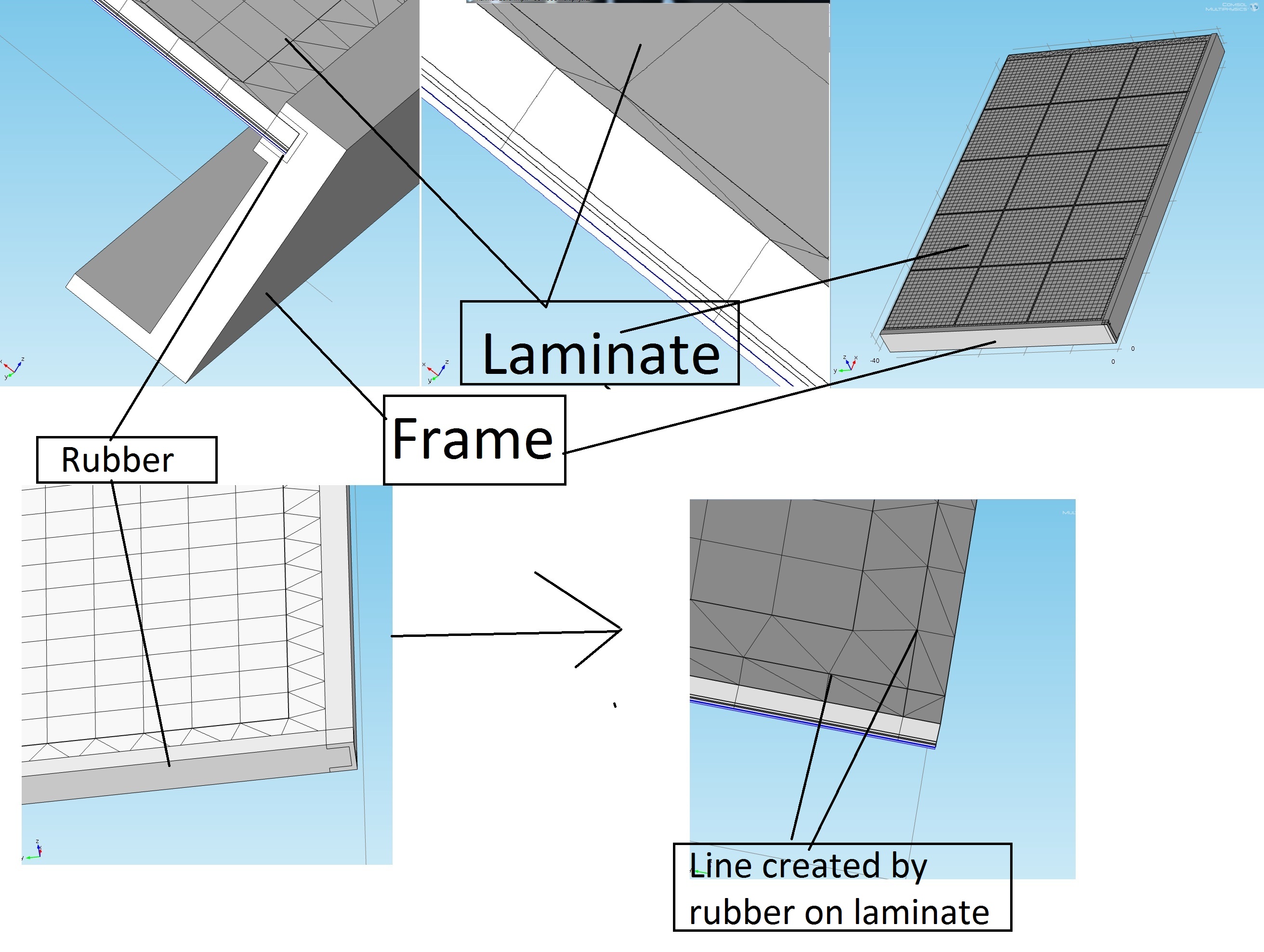

Actually i got a few problems still. i got 5 layers and the same pattern on top layer, botton layer and mid layer. Actually I just want to have this pattern at the third layer, but without also creating it on the mid layer i cant sweep it with the line wich is created by the rubber. I can sweep it until the last layer but there it says that each target area must be unique to one or more source areas. Even i have the same pattern on top and botton surface i cant copy it to the botton surface and mesh it with the existing swept mesh on the top side of it.
Id like to sweep the net down on the last layer and finally do tets on the frame and the rubber in between the laminate and the frame.
Right now im kinda clueless even I tried to mesh the layers from both sides and sweep it. Id be curious how you would solve it and give you the model just to put a mesh on that fifth layer and mesh the frame+ rubber so i could understand where my problem is but this model is a little big for uploading (30 mb). But if you would do it, id be really happy and send it to you via e-mail or something.
But i feel im not that bad by now for studying this programm myself at evenings. I attached the file with some textmarks inside for better understanding.

*but without also creating it on the TOP layer i cant sweep it with the line wich is created by the rubber. (you see this in the picture)

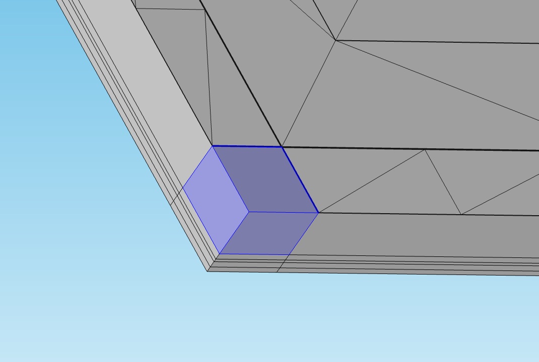

Ok now i created all layers with the same geometry (was a lot of work somehow) but now he tells me that all source domains must be connected.

Somehow he doesnt like this, but i dont know why.
Posted: 1 decade ago 19 apr 2013, 14:09 GMT-4
you are right the sweep mesher requires that all your layers are structured the same way, which means often you need to be clever to use the domain selections to reconstruct your patterns, either during geometry definition and /or after meshing and during material, physis and BC definitions. Try to use the advanced features such as tangeant recognition etc, it saves often quite some time ;)
