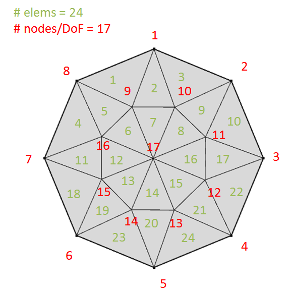

Why can't you have more elements than nodes? You definitely can. See attached mesh with 24 elements and 17 nodes.
Also, I created a simple cube and meshed with an extra fine mesh resolution with the free tetrahedral mesher.
Results:
~400k linear elems
~69k DoF (nodes)
That is a ratio of 0.175 -- very close to the value given by the Knowledge Base post you referenced:
(#of DoF) = 0.2 * (#of Elems)
Josh Thomas
AltaSim Technologies
Joerg- Why can't you have more elements than nodes? You definitely can. See attached mesh with 24 elements and 17 nodes. Also, I created a simple cube and meshed with an extra fine mesh resolution with the free tetrahedral mesher. Results: ~400k linear elems ~69k DoF (nodes) That is a ratio of 0.175 -- very close to the value given by the Knowledge Base post you referenced: (#of DoF) = 0.2 * (#of Elems) Best regards, Josh Thomas AltaSim Technologies

Hey Josh,
thank you so much for this picture. That was a real eye opener. I always assumed that there must be more vertices/nodes than tetrahedra. That is why outputs like
Results:
~400k linear elems
~69k DoF (nodes)
confused me in the first place. I just didn't have a proper counter example. Thank you so much. Now my FEM world view is back to normal again. :)
Btw, do you have any idea where the ratio 0.2 is coming from?
Greetings Joerg
Hey Josh, thank you so much for this picture. That was a real eye opener. I always assumed that there must be more vertices/nodes than tetrahedra. That is why outputs like ========== Results: ~400k linear elems ~69k DoF (nodes) ========== confused me in the first place. I just didn't have a proper counter example. Thank you so much. Now my FEM world view is back to normal again. :) Btw, do you have any idea where the ratio 0.2 is coming from? Greetings Joerg
