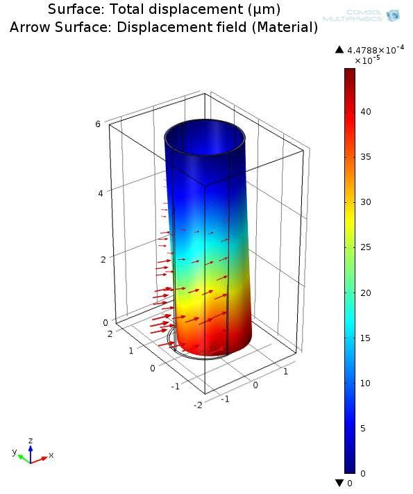

i am designing a pressure sensor......i have got displacement of 0.28nm for applied pressure say 10000 pa...how can i know whether it's correct or not... how are pressure n displacement related to each other, i will be thankful to you if you could tell me how to calculate....

you should always check your results, the easiest is to say you have a pressure P0 applied and than a membrane (circular flat one) of radius Radius and total thickness H gives a deflection (at beam centre = neutral line of , (cf wiki) for a clamped end:
Dz(r) = -P0/(64*D)*(Radius^2-r^2)^2
Dth(r) = P0*r/(16*D)*(Radius^2-r^2)
where plate constant D = H^3*E0/(12*(1-nu0^2)) and E0 the Young modulus and nu0 the Poisson coefficient
and Dth(r) is the rotation of the plate, in COMSOL it's expressed as -0.5*solid.curlUPHI
You will hardly see the differences ;)

Thank u fr the reply...but i did not understand what 'Dz(r)' and ' r ' mean in the relation, could you be more precise on that..actully i am designing a nanotube sensor of length 6 um, radius of 1 um and thickness of 50 nm...i have also attached snapshot of nanotube.

Dz(r) is the Z displacement asa function of r, the same for Th the rotation along the 2D-axi PHI variable, check your doc Plate physics doc

still i am in confusion, what should i put for ' r ' in the first equation??....why negative sign in first equation?? i am applying pressure onto one of the boundaries of nanotube in x -axis direction.
