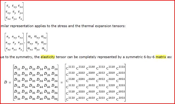

COMSOL assumes the elasticity matrix to be symmetric. I need to define an unsymmetric stress tensor but seems that it is impossible in COMSOL.

Hi Ivar and
Yes, I did. but the anisotropic elasticity matrix still assumes symmetrical tensor. What I need is to define all the elements separately.
for example in my case s12 is not equal to s21.

Hi chris
36 elements for elasticity matrix still gives us 6 elements of the symmetrical stress tensor.
For a 3*3 stress tensor, I need to define all 9 elements separately. in my case s12 and s13 is not equal to s21 or s31.
Do you think that it is possible to define s21 or s31 or s32 in the equation view?
Thank you

You are right, hadn't fully noticed that, and internally it stores only the half of the elements (check the equation view)
You can certainly define them, but then you must enter their values all over in "all" formulas,
The way rebuild your fully anisotropic physics with the "model builder" but that would take some time (I still havent manage to find enough time to learn that feature of COMSOL)
