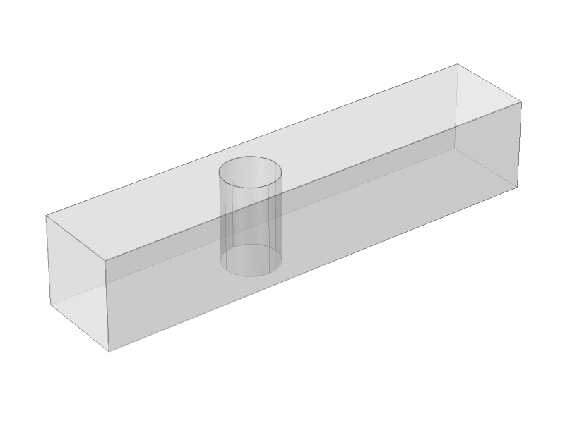

I have a beam , and the force is acting on the top surface of the beam , but only in a certain region. Hence, I should not select the entire top surface as the surface acting for the boundary load, and neither is the force an edge load. Hence, how should I select this region (say it has a certain shape) , so as to apply force to only that part of the top surface. I really do not know whether this is a trivial question or not. I am very new to comsol , and hence not familiar with this.

...or you can simply create an additional body (or face with a workplane) in your geometry (with same material).
This will produce a surface at the top of your beam.
