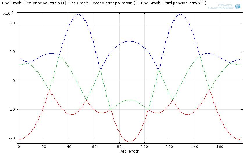

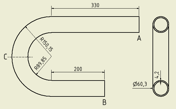

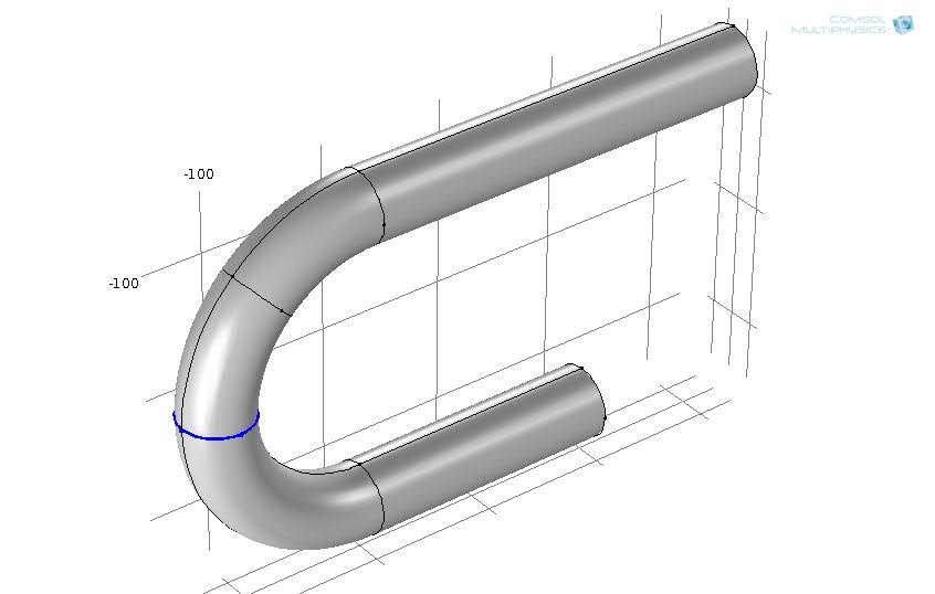

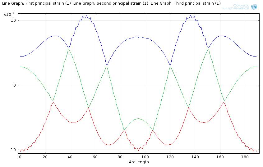

The parameter of the bend pipe, Position for analysis and line graphs for principal strains are uploaded as Attachment. In my Simulation, the pipe is loaded by 300N downwards on cross section A (see photos), cross section B is fixed. The material is structural steel. The position for plotting graph is an outside circle on bend pipe (position C in photo). There are two photos show the principal strains from shell element and solid mechanics. That's obvious to observe the big difference between two graphs.The results of principal strains by shell element are one time larger than meshed by solid mechanics.
And I have also simulated with the shell and solid models in software Autodesk Simulation, the results of stains and stresses are the same as the one from solid model in Comsol . So it means the result of solid model in Comsol is correct,the problem now is just the inaccuracy of principal strain by shell model in Comsol. Is it a mistake from setting and operation by shell element, or maybe a bug in Comsol?

Thank you for your reply, I have simulated by two models with different wall thickness (as shown in the table), but unfortunately it seems that, although the ratio between wall thickness and radius of the tube is already smaller than 1/20, but the inaccuracy is still ridiculously large. Will you get the same result as me?

Hi Alick,
Regarding this problem, my understanding is that the thin-shell theory essentially assumes that the strain in the transverse direction is zero. You can check the magnitude of the transverse strain from the results of 3D solid element relative to the in-plane strain, and see if neglecting it is a reasonable assumption. If the transverse strain is large, then the discrepancy of the results from two approaches are due to the limitation of thin shell theory itself. Let me know what you find.
