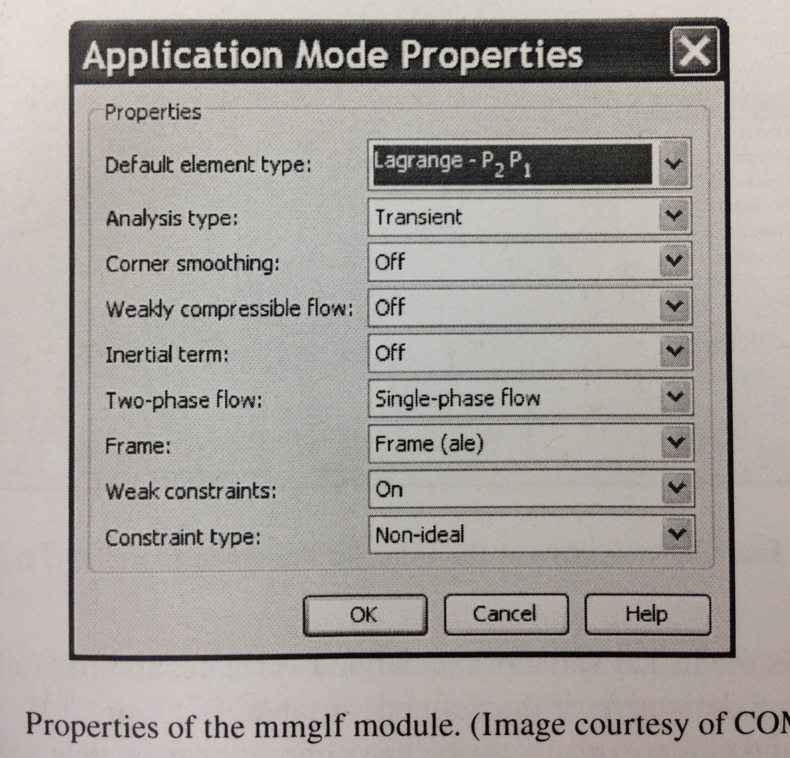

1. "Go to Properties of mmglf model and turn Weak constraints -> On and Constraint type -> Nonideal"
I have found out that the mmglf module is the same as spf module of 4.2a with the Stoke's flow check box checked. I have also found out that I can add a "Weak Constraint" node to the spf module. But I don't know if this should be the volume "Weak Contraint" node or the surface one. Also in the node, Contraint type can be set either to "Bidirectional" or "User-defined" (not Unidirectional which is non-ideal). How do I set it to "Nonideal"?
Note: "Nonideal Weak Constraint" is used to automatically calculate the hydrodynamic stress on the particle surface.

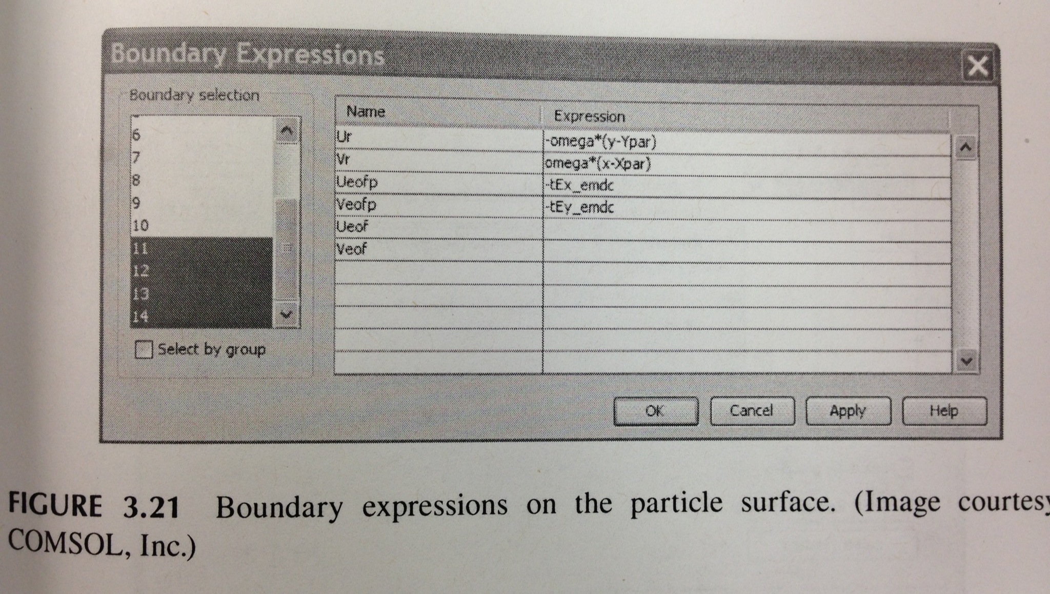

2. "Options Menu | Expressions | Boundary Expressions"
How do I write Boundary Expressions? I feel Coupling Variables is to be used, but I am not sure how. I was only able to find Integration/Summation to the boundaries.

The weak constraints should be applied on the boundaries. If you can select 'non-ideal', select it; if not, the 'non-ideal' is by default (what they say from the documentation).
For the boundary expressions, you can define variables on the corresponding boundaries in "Definition".
