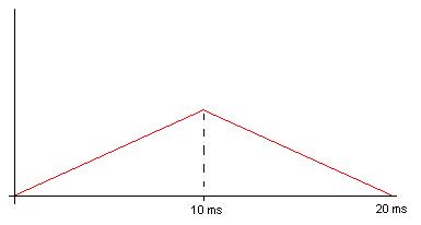

I'm trying to build a periodical wave. I want it to be linear, with its first semiperiod as an ascendent linear function, and the second semiperiod as a descendent linear function. Just like in the attached image.
