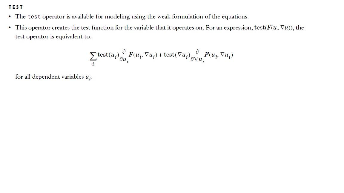

Posted: 9 years ago 11 giu 2015, 17:48 GMT-4
In the attached image is the answer for the test function. hope helps
