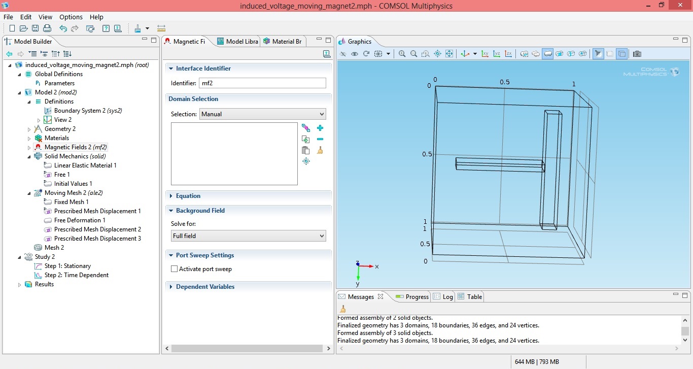

I am confused about that, Plz have an overview of the attached file, this can make my case clear:
Plz plz guide me that which "Physics+Study" should be carried out for the voltage induction from a rectangular beam of a magnet (parallel to x axis ) to a simple coil (parallel to y axis)? The beam is fixed at one end.
What I am trying is moving mesh, solid mechanics for fixing one side of beam and applying force for displacement and magnetic field physics (ampere's law & multi-turn linear coil with reference edge).
Which domains I should use in moving mesh (if it is required)? In output I want a SINUSOID.
And last querry please Comsol inquires about Young's Modulus and Poisons Ratio for air? What values should be used?
Waiting for your kind reply.
Best Regards
MF
Looking at the screenshot of your mode, I assume that entire coil is fixed, beam is cantilever and can move due to Lorentz force. Based on these assumptions, several notes on your model:
1. All domains should be selected in Magnetic Fields (mf2) interface;
2. Only beam should be selected in Solid Mechanics (solid) interface;
3. Only air domain should be selected in Moving Mesh (ale2) interface. Young’s modulus and Poisson’s ratio for air are not needed. Comsol is asking these properties because you included air domain in Solid mechanics interface.
4. Beam movement is governed by Solid Mechanics interface, so it is not necessary to include beam in Moving Mesh interface. However, use Prescribed Mesh Displacement boundary condition in Moving Mesh interface to set displacement of the beam boundaries to (u,v,w).
5. Apply Maxwell’s stress tensor forces on all boundaries of the beam in Solid Mechanics interface. This is the coupling between Magnetic Fields and Solids Mechanics.
6. You coil looks very strange: where is closed loop for current flow?
7. You can get away with only one Time Dependent study step.
Sergei

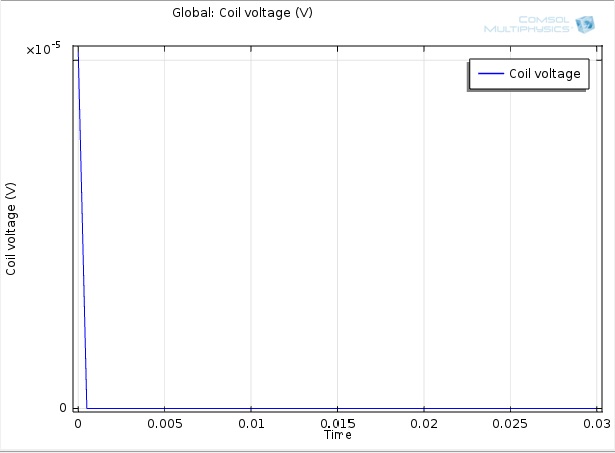

And off course thanks for the beam forced vibration and the time dependent study, it is exactly in accordance to what I was striving for. And in the output of induced voltage there is a straight line (file attached) at zero but in previous case of Maxwell stress it was a sinusoid. I am confused in that, please guide about that.

Just guide me about the Sinusoid output of VOLTAGE which a straight line in the last file send by you. Is voltage induced or I am getting it wrong? Whereas Vibrations are perfect and their sinusoid is there.
Please give me that last favour about Sinuoid of VOLTAGE output (which you shared by Maxwell's stress was perfect but it was by Stress). And my work will be done.

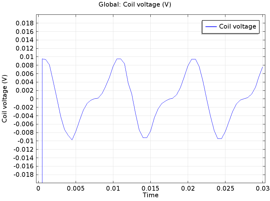

Attached is model with induced sinusoidal voltage of the coil.
Sergei
