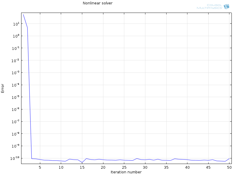

Without knowing the details of your solver configuration, I will attempt to give an explanation.
The graph of the error in the nonlinear solver shows an estimate of the relative error in the solution after each iteration. With default settings, the convergence criterion is 1E-3, so unless you have tightened the tolerances very much, you would expect convergence already after iteration 3.
There are however a number of underlying sanity checks which also need be passed if the solution is to be accepted. In your case, it seems that the error estimate in the underlying linear solver is to large. Think of the nonlinear problem as
What you see in the graph is an attempt to estimate
in iteration i. But while solving the problem using the Newton method, the stiffness matrix
must be inverted in each iteration. When the equation solver doing that job finds that
is ill-conditioned, it will signal an a error. This is the error message that you see printed.
You can suppress this check. Go into the solver sequence, identify the 'Error' section in the 'Direct' node, and change 'Check error estimate' from 'Automatic' to 'No'. If you do so, you will probably get a converged solution, but you must inspect you results critically, since the error estimate in the nonlinear procedure may be inaccurate in this situation.
You can also try setting 'Check error estimate' to 'Yes'. In that case, the nonlinear solver will give up as soon as an ill-conditioned matrix is encountered. In this way you can investigate if your problem is ill-conditioned right from the start, or as an effect of nonlinearities in the solution.
[math] \mathbf K (\mathbf u) \mathbf u= \mathbf f [/math]
What you see in the graph is an attempt to estimate [math] \mathbf u^{(i)} - \mathbf u_{exact} [/math] in iteration i. But while solving the problem using the Newton method, the stiffness matrix [math] \mathbf K [/math] must be inverted in each iteration. When the equation solver doing that job finds that [math] \mathbf K^{(i)} [/math] is ill-conditioned, it will signal an a error. This is the error message that you see printed.
