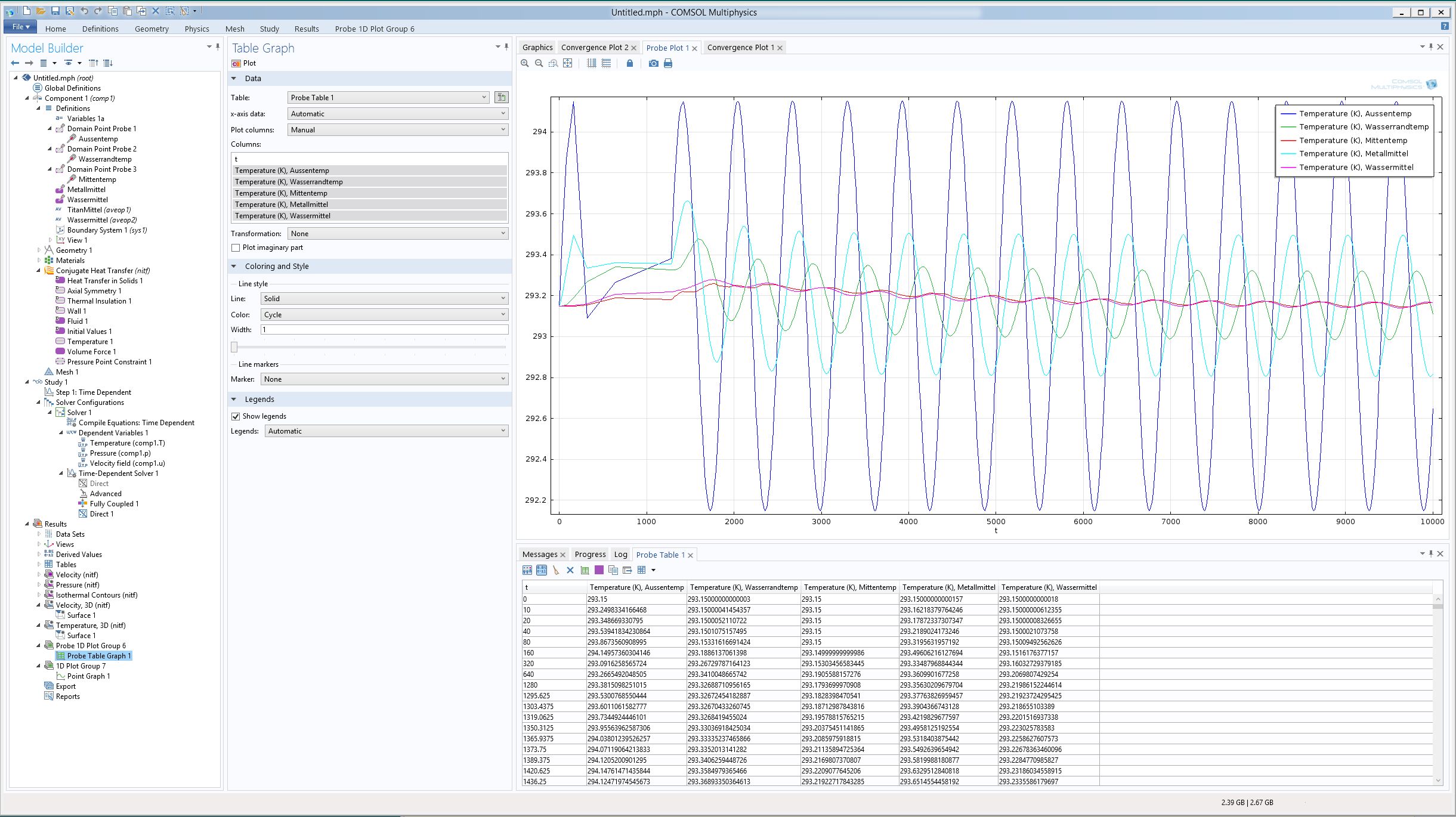

How to limit time step size, when time depend solver neglects Nyquist Theorem?
I have a boundary condition: Boundary Temperature varies as: 293.15[K] + sin(t/100[s]) * 1[K]
The Time Dependend Solver generates a time series beginning with
0,1,10,20,40,80,160,320,640,1280 ...
where the last time step obviously severely surpaces the Nyquist frequency limitation.
So it seems I have to set a limit for time steps manually.
How will I have to do that?
I attach a screen-shot of the problem
3 Replies Last Post 18 mar 2014, 11:53 GMT-4
Posted: 1 decade ago 18 mar 2014, 09:54 GMT-4
When I choose Study/Timed Dependent, there is no place to set a maximum time step size.
It needs one run, to let COMSOL generate a node "Solver Configuration". Opening this one I can dig deeper at: Study 1/Solver Configuration/Time Dependent Solver1/Maximum Step
But this option is only available after an initial faulty run, not during setting up the model for the first run. Correct?
