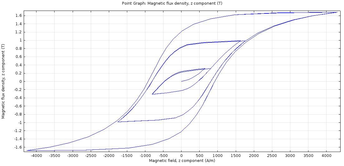

Thank you so much for your help!
It's still not perfect, but It basically works now :)
I attached the Hysteresis Curve I produced :)
Regards
Rook

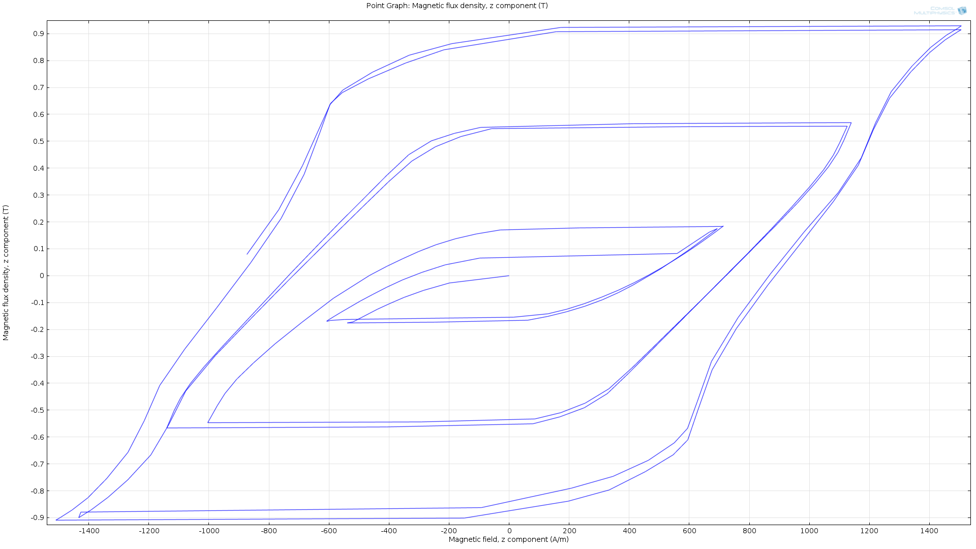

But when I try to rebuild this Model in karthesian Coordinates, the simulation doesn't work. (I actually don't even get an Error Message, the Progress-Report simply stays at 0 %). My guess is, I might have done somthing wrong with the PDEs, but I'm not sure...
I attached the new Model. It would be great if someone could help me figure out what I did wrong this time :)
Regards
Rook

That's exactly whats confusing me. Why does the Model with the cartesian Coordinates take such a long time, while the Model with the zylindric Coordinates is done in half a day? Is this normal, or does it mean theres some mistake in the cartesian Model? I don't really want to run a week long simulation, just to get a nonsense-result due to a falty model.
Is there a way, to make a Simulation run faster, or at least to check, if it works the way you intended to?
regards
Rook
