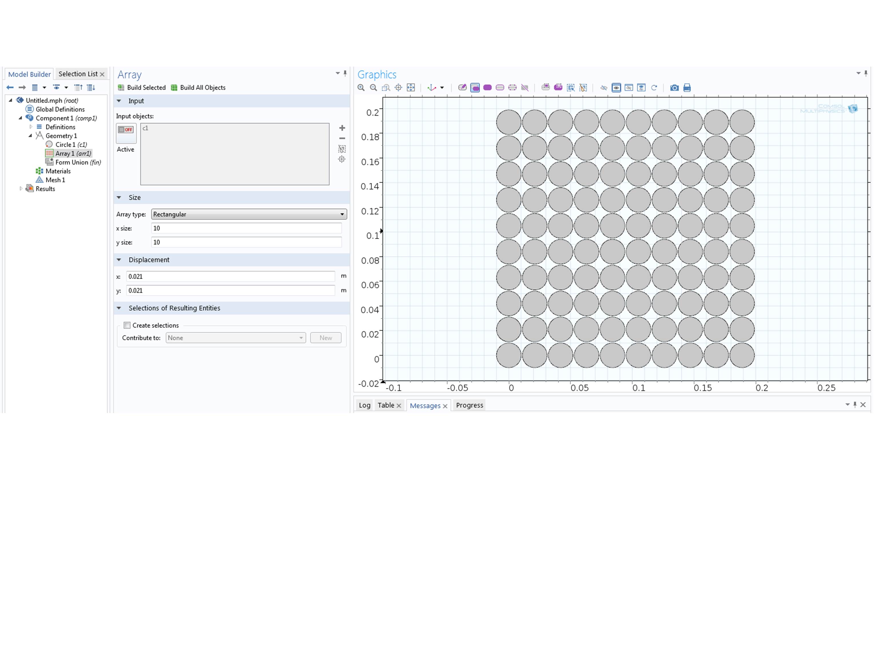

Use an array. Screen capture attached.
BR
Lasse
Use an array. Screen capture attached. BR Lasse
