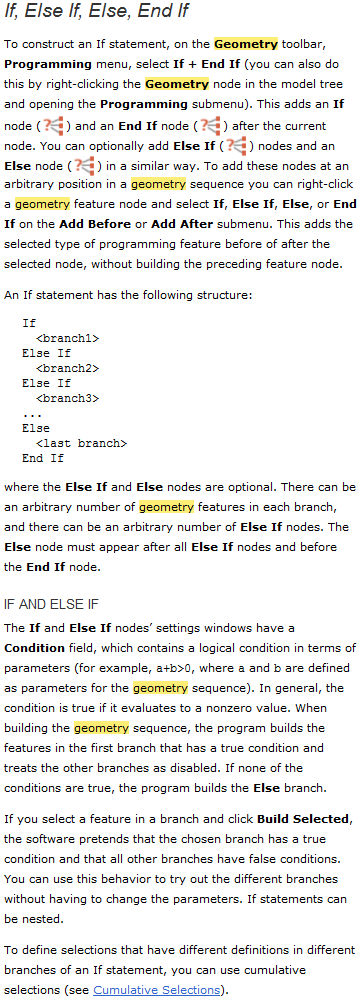

Thank you for your quick response! Perhaps this is what you are trying to show me with the domino.mph file, but I am trying to define a geometry based on a conditional statement as explained in the help documentation which is shown in the attached image. If that's what you gave me sorry for not understanding it better (I'm quite new to COMSOL still). What would be awesome is a tutorial of sorts to understand how to use the feature. Again, thank you for your help!

Hello Richard,
The If calls are in the geometry subsequence called Domino, which you will find under the Global Definitions branch.
That subsequence is later called repeatedly in the Geometry 1 branch.
Jeff

Jeff,
That's exactly what I was looking for! Thank you very much for your help!
