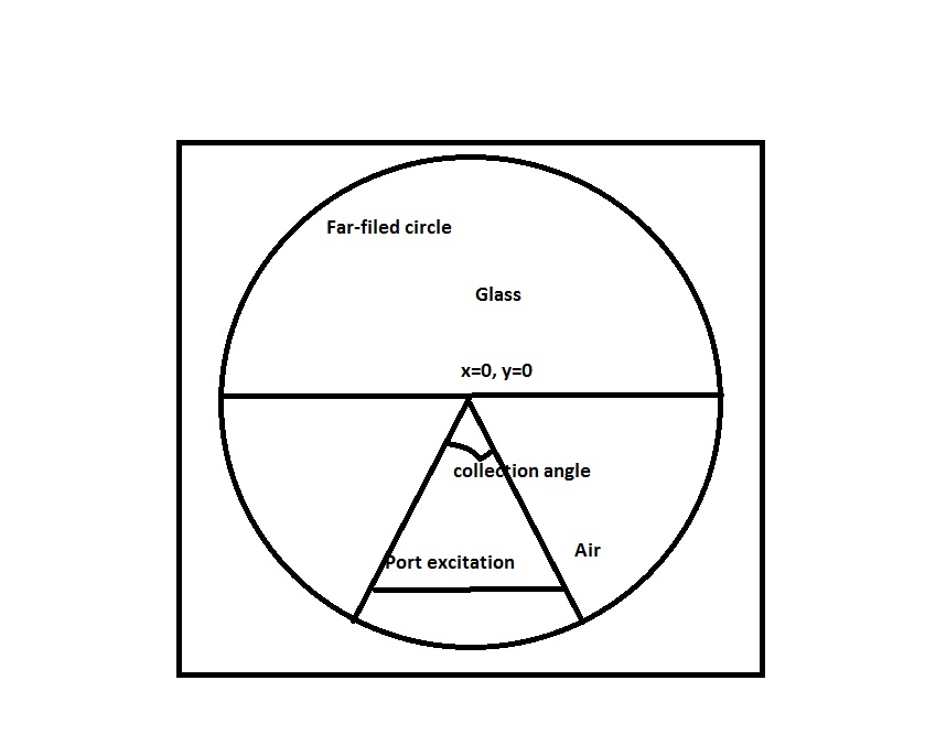

 Have you found a solution how to integrate Efar over the specified boundary in include light collection lens effect?. I am trying to calculate Efar in 2D for 0.65 NA lens?. I defined phi=asin(y/sqrt(x^2+y^2)) and doing line integration in post processing in results section. I defined line integral as Sergai said expect for 2D. I am but always getting 0 for integration.
 I assumed angle calculation starts from first quadrant of the geometry, and given between pi+(pi/2-half angle of lens) to pi+(pi/2+half angle of lens) for back side collection as attached. Can I know my angle definition is correct for attached geometry?
Mahendar
