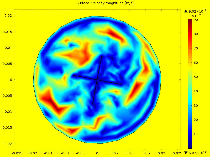

Hope someone will help me. I am calculating the torque in which I am using shear stress, dynamic viscosity etc..
But units are strange for many terms like for density it should be kg/m3 but here it is kg/m2, for dynamic viscosity it should be kg/m.s but here it is kg/s and for shear rate it should be 1/s but here it is m/s..
How can it be possible? I am using COMSOL 4.4

Have you updated v4.4 to the latest version? I had a similar problem that was a bug, but corrected after update to 4.4.0.248.
