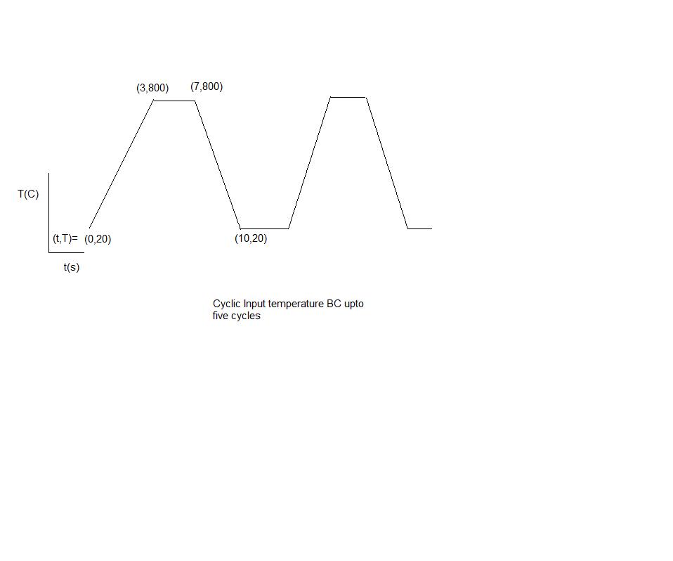

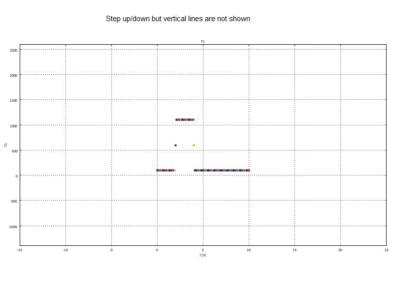

Would anyone help in defining an expression for a cyclic BC-as attached in the figure. Also, in another figure I tried to step up/down but cannot get vertical lines shown, instead only one dot is appeared.
Any help will be appreciated.

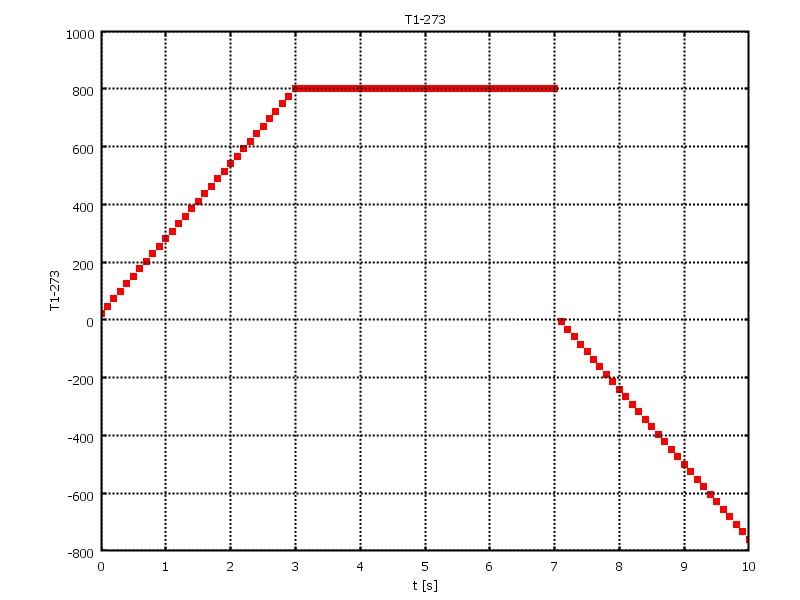

Thanks for your help. Actually it works fine until 7 sec and then the curve disconnects and restrated from zero going down, as shown in attachment.
Also (as in my previous 2nd attachment), is there any way to show the vertical lines (instead of one central dot) when using a step. The use of smooth function does not give vertical lines.

Are you plotting in COMSOl or matlab ?, because in Comsol you can put the units to [degC] and I beleive in the settings of your plots you can choose lines or markers, or both, it should be somewhere in the options on the plot parametr window
